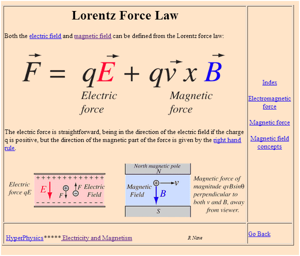

I'm not able to follow your equations without starting at the beginning. Here is what the Lorentz Force looks like as a vector equation:
http://hyperphysics.phy-astr.gsu.edu/hbase/magnetic/magfor.html
It says that the force on a charged particle q due to electric field E is qE and is in the same axis as the direction of E. It also says that the magnetic force on q is qv X B (where "X" is the vector cross product), so that force is perpendicular to both the velocity v and the direction of the magnetic field B.
So if the charged particle is traveling at a right angle to B, then the magnetic force equation reduces to F = qvB, and is perpendicular to both the velocity v and the direction of the B field.
The acceleration that they are giving for the charged particle is due to the centripital acceleration of the particle around the magnetic field lines. You figure out the velocity of the particle based on its initial Kinetic Energy (KE) from the 1.80keV energy it got accelerating in the electric field part of the mass spectrometer.
What is the equation for the acceleration of a particle in uniform circular motion in terms of its mass and velocity and the radius of the circular motion? What is the units conversion from energy in keV to Joules?
