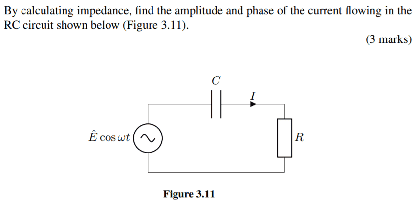

Calculate the impedance in this RC circuit
To calculate the impedance in an RC circuit, the formula Z = sqrt[R^2 + (1/wc)^2] is used. The voltage is expressed as V = E*cos(wt), leading to the current I = E*cos(wt) / sqrt[R^2 + (1/jwc)^2]. To find the amplitude and phase of the current, it's essential to express the impedance as a complex number rather than just its modulus. Understanding complex numbers is crucial for this analysis. The discussion emphasizes the importance of these calculations in analyzing RC circuits.
joelkato1605
By calculating impedance, find the amplitude and phase of the current flowing in the
RC circuit shown below (Figure 3.1
Z =sqrt[ R^2 + (1/wc )^2]
I=v/Z
So Z = sqrt[ R^2 + (1/wc )^2] and V=Ecos(wt) so I= Ecos(wt) / sqrt[ R^2 + (1/jwc )^2] but how do I use this to find the amplitude and phase of the current?

Hi,
Are you familiar with working with complex numbers ?
yeah I've done a bit on them
Can you write the impedance as a complex number (not only its modulus)?
