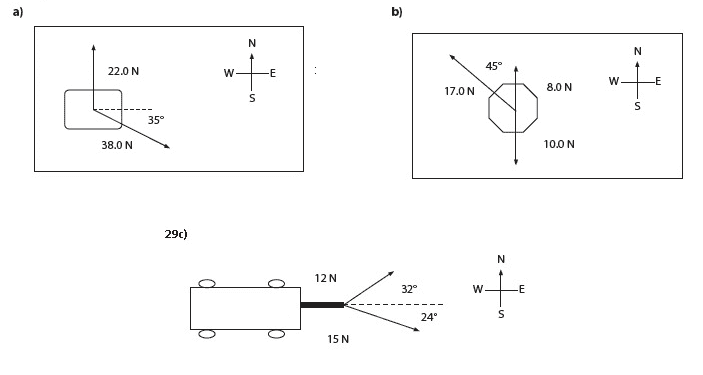

Calculate the net force acting on the object in the diagram
In summary: The components of the 17 N force are (-12, 12). So the sum of the x components is 0 - 12 = -12, and the sum of the y components is 8 + (-10) + 12 = 10. The net force is then -12 i + 10 j. In summary, the net force in Diagram B is -12 i + 10 j.

Calculate the net force in Diagram B.
Sine Law: sin a/a = sin b/b = sin c/ c
Cosine Law: c^2 = a^2 + b^2 -2ab*cos(c)
c^2 = (2N)^2 + (17)^2 -2(2)(17)*cos(45)
= 16 N
sin b/ 17N = sin45/16N
= 49 degrees
Fnet = 16 N (W 49 degrees N)
I am really confused with this unit. I don't know if I did it right, but I would appreciate feedback on where and how i went wrong.[/B]
= 16 N
= 49 degrees
A simpler way to find the net force of two or more vectors is to decompose each vector into its x and y components. Once that is done, the individual x and y components are added together algebraically, and the sum of these components gives you the component of the net force, or the resultant.
In b) above, the 8 N force has components of (0, 8) while the 10 N force has components (0, -10). The 17.0 N force can be converted to its components by completing the 45° triangle shown. Remember, a horizontal component pointing East is positive.
