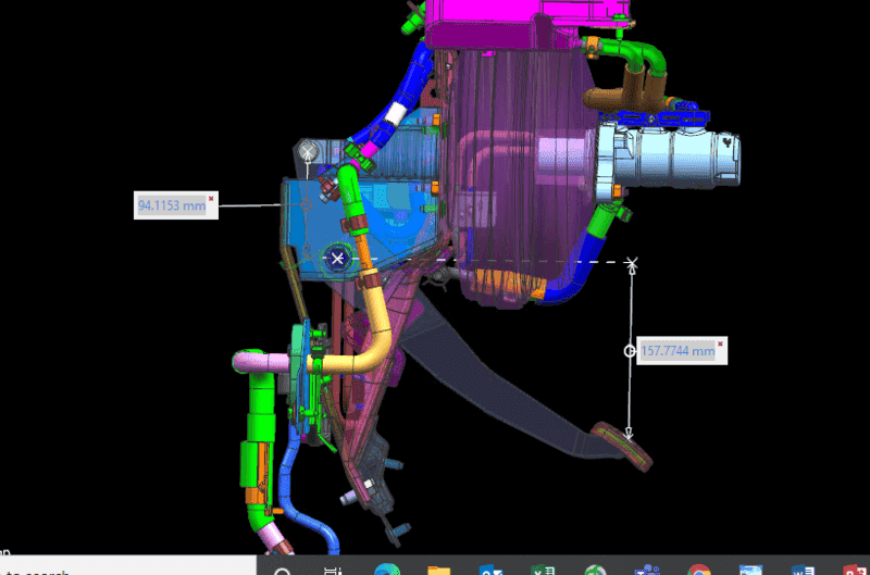

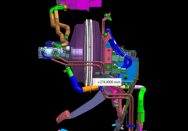

Ok. So see the images below as references to what I am about to say. I did some additional research and this is where I am at:
So CAD data is showing me that the booster is 10.8 inches (O.D). For whatever reason, the diaphragm is not showing up in the CAD and the booster is a solid body, so I found that the typical booster thickness is between 0.125 and 0.500 inches. So I'll assume this is in between that to be safe and say its 0.375 inches thick. So the I.D should be about 10.5 inches. Since the diaphragm seals the chambers, the DIA of the diaphragm should also be 10.5 inches.
Our booster capacity is 4.5 L. Assuming the diaphragm splits the booster in half, each chamber should contain 2.25 L of vacuum.

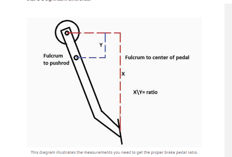

You mentioned the ratio, and after doing some research on that, Here is where I am stuck. So the way I am thinking about it is...the PEDAL ratio will provide the multiple in terms of how the force from the driver will be transferred to the master cylinder (without power assist). I found a diagram that shows how to find this pedal ratio. Following this, I found our pedal ration to be 1.7:1 (which concerns me, because from what I've read, for power-assist brakes, the ratio should be 4:1...). I've read the average person can hit the brakes with 70 pounds of force, so this means that WITHOUT a booster, the brakes would receive 1.7 * 70 = 119 pounds of force.
Now for the BOOST assist, I found a website that said this is roughly calculated by "multiplying the atmospheric conditions by the DIA of the booster, and then multiplying that by the number of diaphragms". Assuming that by "atmospheric conditions", they mean the ATM pressure, then we have 101.3 kPa * 10.5 inches * 1 diaphragm = 1,063 kPa*in...but those units don't seem right to me.
Basically, what I am thinking is that I need a way to relate the amount of force that's being added onto the master cylinder by the booster and how much this will deplete the vacuum (increase the vacuum pressure). So for example, if I know the booster is applying 200 pounds of additional force, and I can somehow relate this to how much vacuum pressure will increase due to supplying this additional force, I should be able to get my answer. I know the atmospheric pressure being let in when the pedal is depressed and the valve is opened will increase the pressure (reduce the vacuum), but this gets pushed out when the pedal is released by a one-way check valve (from what I've read), so Idk how much of the vacuum is depleted after this entire process (atmospheric pressure enters, then exits...how much did this increase the pressure in the chamber?)Am I on the right path here?

Wouldn’t I be able to determine the stroke by the pedal displacement? Using the diagram for the pedal ratio
shown above, wouldn’t this be the equal to the length of the horizontal red line (adjacent to the 90 deg angle)?
Also, if/when I figure out the master cylinder stroke, how would I translate this to the amount pressure that the vacuum now has? My understanding is that each brake application will deplete the vacuum to some degree (increasing the pressure), so how would I correlate the displacement volume with the pressure difference of the vacuum?
Actually, probably not, because it looks like the pedal will never reach a completely vertical position…..so I probably can’t do that to determine the stroke. But I feel like the pedal displacement has to be the main factor in determining the stroke, as the pushrod is what displaces the cylinder piston.
You said something about the travel of the brake pads…..isn’t that like, only a few millimeters away from the rotors? I mean, I realize that the cylinder will continue to travel after the the pads come in contact with the rotors (the “squeezing” down on the rotors)….idk, I’m getting confused now. I think I need to study more about the master cylinder and how that works. This problem might be a bit over my head…
