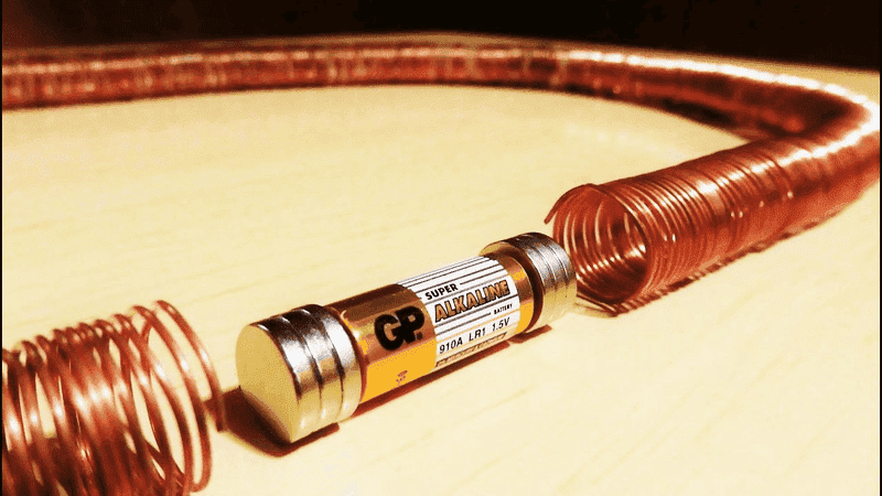

How do you calculate the velocity of the battery with 2 magnets attached on polar ends moving in a coiled copper wire
unknown

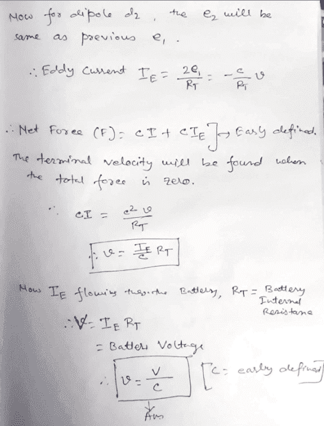

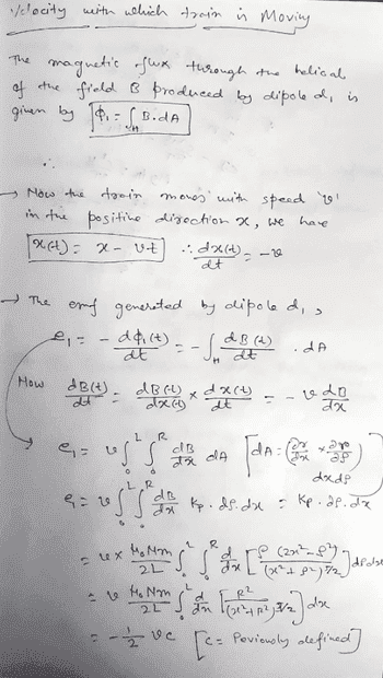

How do you calculate the terminal velocity of the train moving in a coiled copper wire with two magnets attached to the polar ends?
I have attached someone else's work I've found on the internet here and need help 1662076917721.png1662076905411.png1662076725371.png
What are your own thought and attempts?
