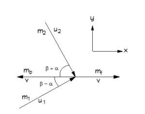

I have two streams that impinge upon one another as shown in the diagram. Stream 1 with mass flow rate of ##m_1## and velocity of ##u_1## impinges upon Stream 2 with mass flow rate of ##m_2## and velocity of ##u_2##. This results in flow in the forward (f) and backward (b) direction of the x axis. ##m_1, m_2, u_1, u_2## are known. I am assuming that the collision is 100% elastic so that no energy is lost as a result of the collision. In addition, the velocity of the two streams after the collision is identical (##v##). After the collision, there are no component momentums in the y direction.
The angles of the collision of each stream, relative to the x-axis, are shown on the diagram.
I want to determine ##m_f, m_b, v##. I will develop the solution for the problem below, but will now state what the issue is. The problem is that the velocity, ##v##, calculated from a momentum balance does not equal ##v## calculated from an energy balance. I'm posting because I need to know if conceptually I am not looking at the modeled solution for this problem correctly.
The general strategy for the momentum balance method is to look at each stream individually and calculate the forward and backward flow for each stream independently of the other stream. Then after these quantities are calculated for each stream they are simply added together to get the quantities for the combined streams in the forward and backward direction. The velocity, ##v## is then calculated from an overall momentum balance in the x direction.
So for stream 1
$$(1)\hspace{1cm} m_1u_1\cos(\beta - \alpha) = (m_{f1} - m_{b1})v_1$$
then since ##v_1 = u_1## because no energy is lost,

A development for stream 2 using the same methodology yields similar equations
$$(7)\hspace{1cm} m_{b2} = m_2\left(\frac{1-\cos(\beta + \alpha)}{2} \right)$$
$$(8)\hspace{1cm} m_{f2} = m_2\left(\frac{1+\cos(\beta + \alpha)}{2} \right)$$
So, I can solve for ##m_b, m_f## as follows.
$$(9)\hspace{1cm} m_{b} =m_{b1} + m_{b2} = m_1\left(\frac{1-\cos(\beta - \alpha)}{2} \right) + m_2\left(\frac{1-\cos(\beta + \alpha)}{2} \right)$$
$$(10)\hspace{1cm} m_{f} =m_{f1} + m_{f2} = m_1\left(\frac{1+\cos(\beta - \alpha)}{2} \right) + m_2\left(\frac{1+\cos(\beta + \alpha)}{2} \right)$$
Now, if I want to calculate the velocity (##v##) of the forward and backward streams after the collision, I'm thinking I can use an overall momentum balance (i.e. for both streams) in the x direction, which is,
$$(11)\hspace{1cm} m_1u_1\cos(\beta - \alpha) +m_2u_2\cos(\beta + \alpha) = (m_f - m_b)v$$
and solving for ##v## yields,
$$(12)\hspace{1cm} v = \frac{m_1u_1\cos(\beta - \alpha) +m_2u_2\cos(\beta + \alpha)}{(m_f - m_b)} $$
All quantities are known so I can solve for ##v##.

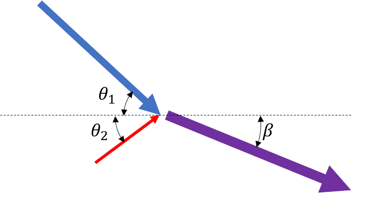

So you have, for example, a stream of milk proceeding at 45 degrees up and to the right. Impinging on this is a stream of water proceeding at 45 degrees up and to the left.
The result after the interaction is a mixed stream of 50% milk and 50% water proceeding at 45 degrees up and to the right and a second mixed stream of 50% water and 50% milk proceeding at 45 degrees up and to the left.
Sure, that conserves both momentum and energy. That particular interaction is just 50% "elastic bounce" and 50% "don't interact".
More generally, one could have an interactor-a-tron which collects the two streams, harvests their kinetic energy (relative to the CoM) and spits out two or more new streams with zero total momentum (relative to the CoM) and the requisite total kinetic energy (relative to the CoM).

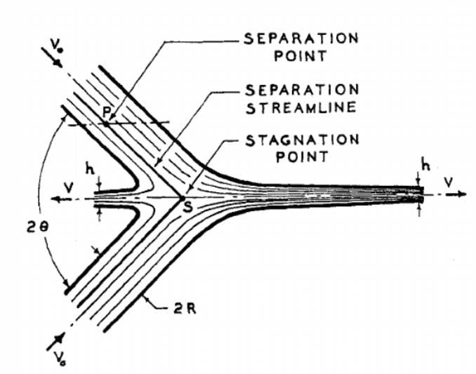

This is not correct if the collision is elastic. The paper by Hasson and Peck from 1964 for impinging streams which are jets that have uniform velocities (throughout the jets) clearly illustrates that there is flow in the backward direction. This is physically observed in experiments with impinging jets. However, their paper assumes equal incoming streams and therefore there is no deflection angle relative to the x axis. Further, they assume that the velocity for both the forward and backward outgoing streams is the same.
If you look at the diagram, it is the stagnation point which results in flow in the forward and backward directions (flow is diverted around the stagnation point). The quantities of each flow can be determined if the separation stream line is known.
See the attached diagram.

rdemyan said:
The paper by Hasson and Peck from 1964 for impinging streams which are jets that have uniform velocities, throughout the jets, clearly illustrates that there is flow in the backward direction. This is physically observed in experiments with impinging jets. However, their paper assumes equal incoming streams and therefore there is no deflection angle relative to the x axis. Further, they assume that the velocity for both the forward and backward outgoing streams is the same.
Yes, that's exactly what I envisioned in post #13.

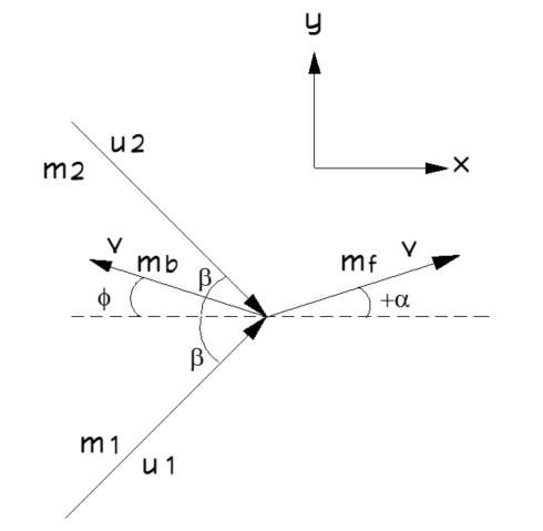

Attached is an updated diagram of the impingement of unequal streams. Here I am assuming that the velocity of the forward and backward outgoing streams is the same. However, the angles of deflection are not the same. The drawing assumes that the momentum of incoming stream #1 is greater than incoming stream #2. The deflection angle, ##\alpha##, will be positive as shown, but I'm not sure about ##\phi##. Maybe the backward outgoing stream will point downward instead of upward as shown in the diagram. This might well be a function of the impingement angle, ##2\beta##.
I need one more equation. Probably some type of relationship between ##\alpha## and ##\phi## probably including ##\beta##.
Here are the equations I currently have,
Momentum:
$$m_1u_1\cos\beta + m_2u_2\cos\beta = m_fv\cos\alpha - m_bv\cos\phi$$
$$m_1u_1\sin\beta- m_2u_2\sin\beta = m_fv\sin\alpha + m_bv\sin\phi$$
Mass:
$$m_f + m_b = m_1 + m_2$$
Energy (assuming a perfectly elastic collision):
$$v = \sqrt{\frac{m_1u_1^2 + m_2u_2^2}{m_1 + m_2}}$$

rdemyan said:
Right now I'm trying to solve a case where ##\alpha + \phi## = 90 degrees. This happens for billiard balls when the masses of each ball are the same and if the collision is perfectly elastic. So, I am setting ##m_1 = m_2##. with ##u_1 > u_2##. Then I'm guessing ##\alpha## and calculating ##m_b## from both the x momentum balance and y momentum balance. ##\alpha## is adjusted until the calculations for ##m_b## from the two momentum balances are the same. Seems like this should apply to the system I'm working on. But, at the moment kind of strange results and I need to check for errors.
I guess I don't understand something. With a billiard ball model, ##m_f,m_b## must be equal to ##m_1,m_2## in some order. Are you allowing the billiard balls to break, while undergoing elastic collision?
I'm not sure what I'm doing is correct at all. I'm just trying to see if somehow I can get something to work. No, I'm not allowing them to break. ##m_f + m_b = m_1 + m_2## is true and for this specific case ##m_1 = m_2##. But if the assumption that the angles sum to 90 degrees requires that ##m_b = m_1=m_2##, then this won't work. I am getting results where this is not the case, but the angles seem weird. For example, if ##u_1## is 1000 times greater than ##u_2##, shouldn't the deflection as measured from the x-axis be pretty close to the incoming half angle of ##\beta## because sheet 2 isn't able to deflect sheet 1 much due to the much much lower momentum. But I'm only calculating a deflection of about 8 degrees for ##\alpha## but 82 degrees for ##\phi##.
EDIT: Actually, I think I have this wrong with regards to deflection. If the ratio of velocities is 5, then ##\alpha## is equal to 2.1 degrees which is large deflection of the greater momentum stream. If the ratio of velocities is 1000, then ##\alpha## is equal to about 8 degrees, which is less deflection, which seems correct but also seems very low.
Can you prove that from the Conservation of Momentum and Energy?
$$ \mathbf{v_1} +\mathbf{v_2} = \mathbf{v'_1} +\mathbf{v'_2} $$
$$ \mathbf{v_1}^2 +\mathbf{v_2}^2 = \mathbf{v'_1}^2 +\mathbf{v'_2}^2 $$
Because I believe that is true if one of the particles is initially at rest, but it doesn't seem it would be the case in general.
I've given up on this and you are most likely right that it only works if one of the particles is initially at rest.
You can always transform into a reference frame, where the fluid in one of the incoming streams is initially at rest, while the fluid in the other stream initially moves along one axis only. Then you solve the (potentially simpler) problem there, and transform the resulting outgoing velocities back to the original frame.
Just don't confuse the direction of the velocity of the fluid in a stream with the orientation of the stream. They are parallel in your original frame, but not necessarily in other frames.
  • #31
I'm going to try to switch to the zero momentum frame of reference. Should I start a new thread as I am definitely going to need help?
