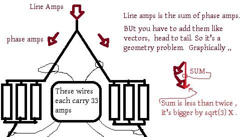

Hi all, a pretty simple question. I want to be able to calculate the load on a 100amp 3 phase service. As an example if I have 9 lighting fixtures that are rated @ 11 amps 208v each (auto ranging 200-240v actually but service will be 3 phase so 208v ish)
Putting evenly across each leg x,y,z I get 66 amps per leg. At this point you would multiply by 1.732 or divide by 1.732 each leg total to get a more accurate load? Or am I missing a step? Or just totally off...

Thank you for your response. Just a follow up. You list 33amp *sqrt3 = 57amps per leg. why 33amp to start? Power Distro wiring would distribute power as:
Leg X...leg Y...leg Z
11a...11a
...11a...11a
11a.....11a
It wouldn't be 22a * sqrt 3 = 33amp per leg
Where did the additional 11amps come from?

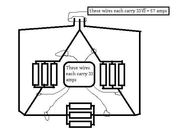

so i drew three fixtures across each phase, as shown, and 11 X 3 = 33 .

That's only six fixtures not nine.
Did i miss something ?

JJinNR said:
why don't you add up each column (leg) & multiply by 1.732? ( so 66 amps * 1.732 = 114.312amps)
Ahhhh back to your original question, where does the √3 come from...
Take a snip from my sketch:
(sorry- the brown print didn't stand out as bold as i wanted..)
sophiecentaur said:
@jim hardy . I notice you chose a delta connection for your example. I don't know much about standard practice but isn't WYE connection more common?
Ahhh here in US for medium size facilities like a motel or something
they bring in four wire wye three phase 208 volt phase to phase
because phase to neutral for that arrangement 208/√3 = 120.
Big loads they connect phase to phase, hence his 208 volt lighting fixtures ,
observe he's hooking up 208V X 11A X 9 = 20.6 kva of them. ( Imagine the resistance heat load for such an installation. )
Ordinary 120 volt receptacles are connected line to neutral.
We call it informally 'a 208/120 feed'..
That's why i drew his 208 volt lamps phase to phase. I just divided them equally among the phases.
I didn't show the neutral because the drawing was cluttered enough , and he didn't mention any 120 volt loads.
