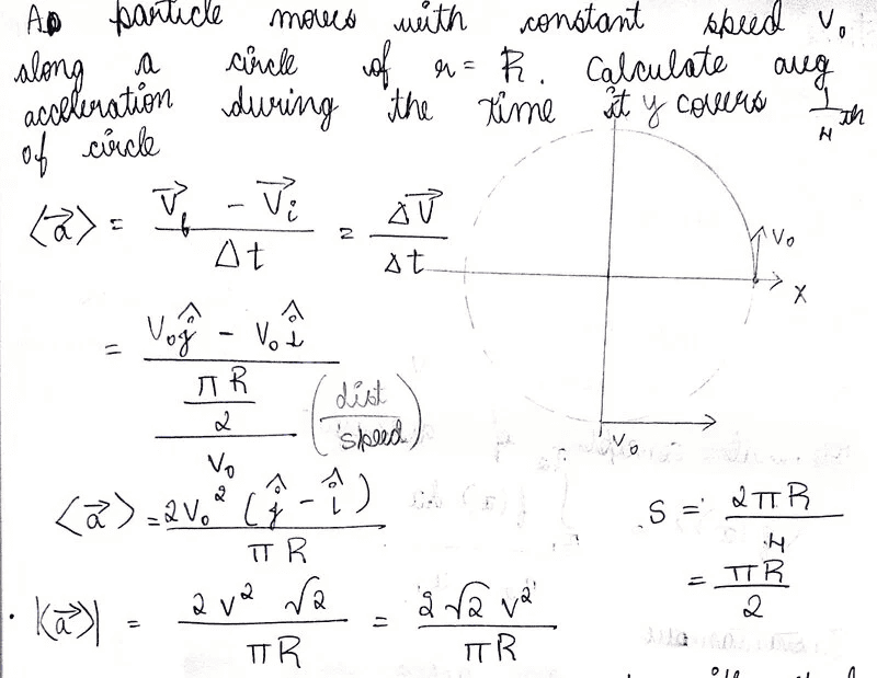

A particle moves with a constant speed along a circle of radius R. Calculate the average acceleration during the time it takes to cover ##{\frac{1}{4}}^{th}## of the circle.
Calculate the average acceleration using the formula, ##<f(x)> = \frac{\int_{x_1}^{x_2}f(x)dx}{x_2 - x_1}##
##<\vec{a}> = \frac{\vec{V}_f - \vec{V}_i}{\delta t}##
I was given two HW questions, I was supposed to solve on using
##<\vec{a}> = \frac{\vec{V}_f - \vec{V}_i}{\delta t}## and another using
##<f(x)> = \frac{\int_{x_1}^{x_2}f(x)dx}{x_2 - x_1}##, I was able to solve using the first formula but I wasn't able to do it with second (at least I got the wrong direction maybe)

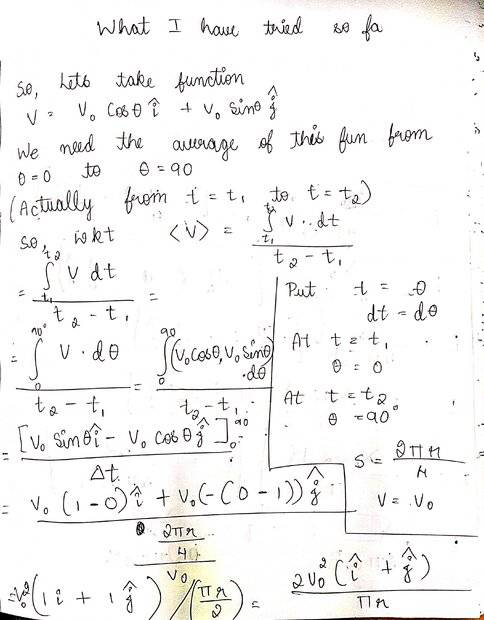

What did I do wrong in "What I have tried so far"? (second image)
Was it wrong to assume ##\theta = t##? (Thanks for the help)

It is not clear what you are expected to do with the first formula because acceleration is a vector and the formula with ##f(x)## is not a vector equation. The definition of angular acceleration is the second formula $$\langle \vec a \rangle=\frac{\Delta \vec v}{\Delta t}.$$ This problem should have been clearer about where exactly on the circle one should consider the path of the particle.
Likes malawi_glenn

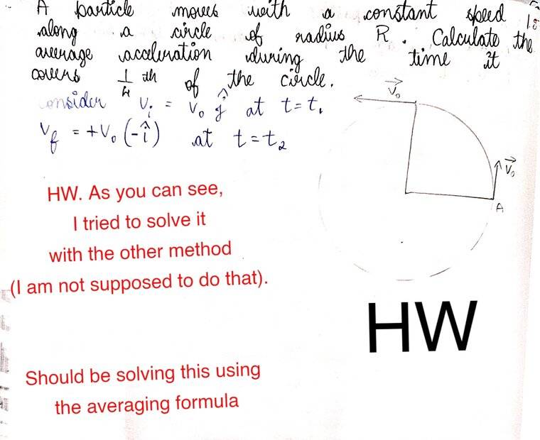

Ok, I see what you are doing. On the third page you use the second equation to get the correct answer as a check, but really you were supposed to get there using the first equation. As @kuruman said the first equation isn’t written as a vector equation, but on your second page you tried to correct that and make it a vector relation.
So what went wrong? I think the problem is that you are averaging velocity over time and not acceleration or force over time. You wrote the velocity vector as a function of theta. You know you can parameterize theta as time. Go ahead and write the velocity as a function of time, take the derivative to get acceleration, and THEN do the integral to get the average of acceleration over that time.

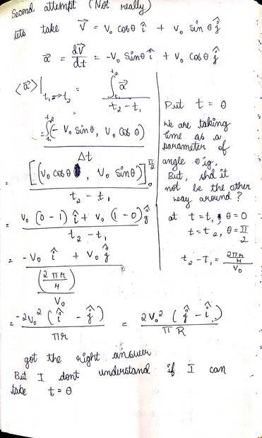

edit: as @Cutter Ketch mentioned in #3 2nd para, I was finding out the average velocity instead of acceleration. So, I rectified it and got the right answer. But, one doubt still remains. Was I right in assuming time t was a parameter of ##\theta##?

It was. It was a lecture actually. He explicitly said so. ##\frac{\Delta \vec{v}}{\Delta t}## is the first method of c

You do not say whether the motion is clockwise or anticlockwise, nor the initial direction. I assume what is wanted is the magnitude of the average acceleration, so those won't matter.
You started out by writing the expression for average velocity, not average acceleration:
##<\vec v>=\frac{\int \vec v.dt}{\Delta t}##.
This should have produced ##\frac{\Delta \vec s}{\Delta t}=\frac {2}{\pi}v(\hat i+\hat j)##.
But then you equated ##dt## to ##d\theta##. That is dimensionally wrong; a time is not an angle. The correct translation would be ##dt=\frac{dt}{d\theta}d\theta=\frac Rvd\theta##, so instead you got ## \frac {2}{\pi}\frac{v^2}R(\hat i+\hat j)##. By sheer luck, that is the average acceleration!

I did do that, thanks to you! and I got the right answer. I still have a doubt tho, was I right* in taking time t as a parameter of ##\theta## as I did in both my solutions? Would you be able to explain this please

can you tell me how $$\frac{d t}{d\theta}d\theta =\ \frac{R}{v}d\theta$$ ?
##\frac{d t}{d\theta}=\frac 1{\frac{d \theta}{dt}}=\frac 1\omega##.
##v_{tangential}=R\omega##.
Again, you got the right answer by two errors that happened to cancel.
In post #1, your first error was writing the expression for average velocity instead of average acceleration. In post #8, you effectively did the same but by a different route.
You started with the right integral expression this time, ##\frac{\int \vec a.dt}{\Delta t}##, but your expression for ##\vec a(t)## was wrong. From ##\vec v=v\cos(\theta)\hat i+v\sin(\theta)\hat j## you thought you differentiated wrt t, but instead only differentiated wrt ##\theta##:
##\frac{dv}{d\theta}=-v\sin(\theta)\hat i+v\cos(\theta)\hat j##.
##\frac{dv}{dt}=\frac{dv}{d\theta}\frac{d\theta}{dt}##.
As in post #1, this error equates to a factor of ##\frac vR##, and in each case you cancelled that error by then writing ##d\theta=dt##.
The bottom line is that one does not merely integrate or differentiate an expression; these operations are always with respect to a specific variable. The derivative of ##\sin(\theta)## wrt ##\theta## is ##\cos(\theta)##, but if you are differentiating wrt another variable then you need a factor representing how changes in those two variables relate.
