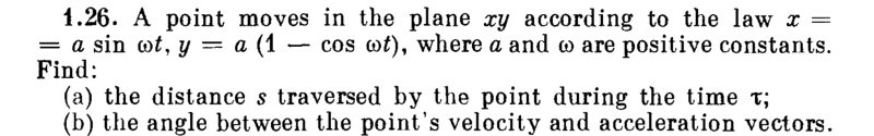

A) [/B]
s = √[(x2) + (y2 ) ]= a√[2(1- cos (ωt) ) ]|t= Γ
The book says, s = aωΓ
What I can do is ,
For very small Γ i.e. ωΓ<<1 , cos (ωΓ) ≈ 1 - {(ωΓ)2}/2
Then , I get,
s = aωΓBut, in question it is not given that ωΓ<<1. So, is it correct to do this approximation?
B)
In many questions, Irodov asks to find out the angle between velocity and acceleration.
Does this angle have any physical significance?
I mean if I know this angle what can I tell about the motion?
Why is one supposed to know this angle?
Your equation for distance traversed is wrong. It should read ds2=dx2+dy2, not s2=x2+y2.
Thanks.
Learning , I should be careful while calculating magnitude of the displacement or distance. There is a tendency to get confused between the two.O.K. So, s is the magnitude of the displacement traveled in time Γ.
ds2 = dx2+dy2
dx = aω cos(ωt) dt
dy = aω sin(ωt) dt
dx2 = (dx) (dx) = [ aω cos(ωt)]2 (dt)2
dy2 = (dy) (dy) = [ aω sin(ωt)]2 (dt)2
ds2 = [ aω ]2 (dt)2
ds = aω dt
0s ds = aω ∫0Γ dt
s = aωΓ
And for ωΓ <<1,the distance is approximately equal to the displacement.
Is this solution correct?
Pushoam said:
Thanks.
ds2 = dx2+dy2
dx = aω cos(ωt) dt
dy = aω sin(ωt) dt
ds2 = [ aω ]2 (dt)2
ds = aω dt
0s ds = aω ∫0Γ dt
s = aωΓ
Yes. (But the original uses ##\tau##, Greek lowercase tau, which you are writing as ##\Gamma##, Greek uppercase gamma.)
What about this question?
Not sure that the angle has any general meaning in itself. Certainly you can say interesting things about the extreme cases (collinear and orthogonal), and likewise regarding the sine and cosine of the angle.
