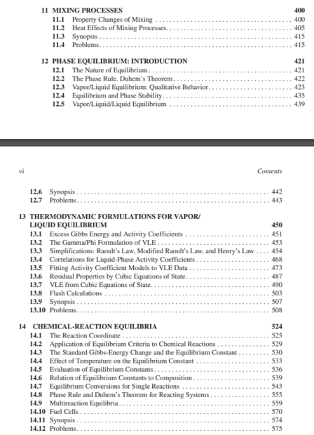

Hello again,
I want to figure out which chapters you are refering to.
Can You please post a screenshot of the chapters or name the titels of the given and important chapters?!
Bellow is a screenshot of the 8th version.
have a nice day and thanks in advance
Olli Meyer
