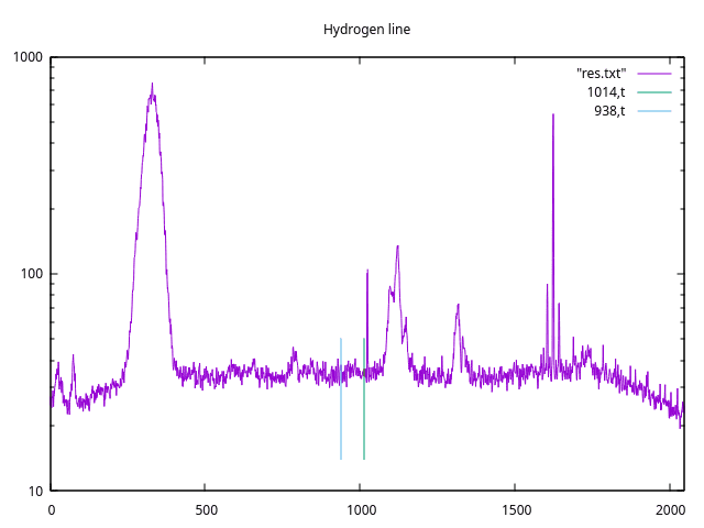

I've made a small program that does FFT, Fast Fourier Transform on a signal from radio receiver (RTL SDR), and parabolic antenna. Of course, the output is amplitude depending on frequency.
I want to use it to detect and measure 1420MHz radiation from space. But I'm not sure on what's the best way to do it. I know the intensity is proportional to amplitude squared, and intensity I= P/A., where I is intensity, P is power received, and A is area of my antenna.
A common unit in radio astronomy seems to be Jansky (flux density) which is proportional to P/(A*bw) where P is power received, A is area of the receiving antenna and bw is bandwidth of your receiving system.
So, I'm a bit confused... My assumption is that I should measure what my antenna is outputting in Janskys. (is that correct?)
That means:
flux density= I/bw=V^2/bw, where V is output from my receiver. But since I'm doing a FFT over a range of frequencies (about 2MHz), what should I do here? How can I calculate flux density from my FFT result? Integrate the amplitudes over the frequency range?? Something else?

As I said, I'm recording data from RTL SDR, which records in-phase and quadrature data (IQ). I record N samples, then do FFT on them and get frequency domain data. The goal is to somehow calculate the power received from certain bandwidth around 1420MHz. What I'm hoping is to be able to detect when Milky way is passing in front of my antenna and hopefully detect increase in power received.

So basically that means I can simply integrate the squares in frequency domain and get received power?
The video suggests integrating the frequency response by counting squares. As the display is in decibels this will not work, because decibels cannot be added.
Further, although the spectrum analyser says it displays power, how is this likely? The A to D converter is a voltage measuring device. To measure power in any slice of spectrum we need to use a square law detector; we cannot do it using a linear detector (such as an A to D) followed by a correction to obtain RMS, because we do not know the shape of the wave.
So you are hoping to see the received power from hydrogen alpha increase as the Milky Way passes across your field of view. Ok. Do I understand that you've simply recorded a time series of data and Fourier transformed the entire thing? If so, I don’t think that's the right approach. If you filter it as I suggested you will lose the modulation, which is what you are trying to detect.
What a spectrum analyser does is (simplifying somewhat) Fourier transform the last hundred (or whatever) data points, so you get a time series of the average power received in each frequency range over the preceding 100 sample periods. The more samples you include in the window the finer the frequency ranges you can detect, but the more time you have averaged over and the worse your time resolution is.
I think you want to look up "windowed Fourier transform", and listen to people here who appear to know more about it than I do. 😁

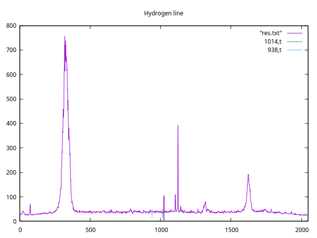

Would it work if I would choose linear y-axis instead of logarythmic?
Left one is log, right one linear. Just a notice, these graphs are taken at slightly different times, that's why they look a bit different.

1) Do I understand that you've simply recorded a time series of data and Fourier transformed the entire thing?2)I think you want to look up "windowed Fourier transform", and listen to people here who appear to know more about it than I do. 😁
1) No, I'm doing a transform on 2048 samples, I forgot to write that. Entire thing is 262144 samples if I remember correctly.
2) I'm using Hann window. I've noticed slightly different looks to the graph with and without the window function so I'm guessing it works. How I'm implementing it is, before FFT I'm multiplying sample value with window function (which is dependent on "n", sample number). I'm multiplying both I and Q components, I'm not sure if that's the way to do it, I'm experimenting until I find out how it works :)
And one more thing. These graphs are made by averaging FFT output from 50 different "passes" of 2048 samples each. When not averaged they are very noisy.
And although the graph says "Hydrogen line" this is, of course not it. The graphs are taken at 93MHz center frequency.

When integrating, the Y axis must be in power and not decibels of power.
I know. If you look at my post, post number 14 https://www.physicsforums.com/threa...nsity-of-radio-telescope.1002515/post-6486692, you will see that I'm using logarithmic scale on purpose, so that it's easier to compare with spectrum I'm seeing in SDR programs which use logarithmic scale.
Right graph is what I'm getting when plotting output from FFT in linear y scale.
If anybody is interested, I'm using fftw library to do FFT.
