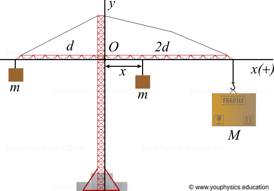

I have a body moved by a crane hook and I want to represent the forces that act on the body in the case of translation, rotation and roto translation. Can someone help me?

Ok, so here you can see a scheme of my problem. I need to show graphically the forces that are applied on the hook that sustains the mass M. I have three cases to work on:
A) the crane is not moving, only the rope is moving vertically to lift and to lower the weight
B) now the crane is moving on a plane on the left or on the right, now the rope is not moving vertically
C)Now the crane is moving on the horizontal direction and the rope is moving on the vertical direction, so basically is a combination of point A and B
Ps: don't consider the two weights m.
Thank you

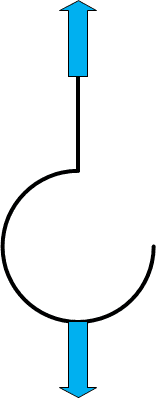

fisica15 said:
the crane moves the rope up : there's the tension on the rope and the weight of the mass M. The forces are on the axis of the rope, the weight goes down and the tension goes up. This is what i think is true
Something like this ?
Likes Delta2
Lnewqban said:
only one force can be acting on it.
At least two, surely.
If one expects the hook to accelerate or to rotate or swing then the one expects the forces to sum to something different from zero and for the individual lines of action not to all pass through the center of mass of the hook.
I estimate that would become too complicated. Propose to treat the hook as massless.
Agree, @fisica15 ?
If you experiment with a mass on a string, you can see how hard it is to move the suspension point (your hand) from one position to another without making the mass go into a swinging motion.
Can you propose a suitable FBD for a massless hook ?

By the way, I was already considering a massless hook, the weight is given by the mass moved by the hook. Then, i prefer to consider a realistic situation for my work and in fact, in reality you can see that an object moved by a crane tends to oscillate, because the rope, the hook and the mass tends to behave as a pendulum.

I know, but when the crane is moving horizontally, then the forces applied on the hook will have different angles i guess and i think there will be also a rotation of the hook
It seems that the problem is not asking you to calculate anything, only to show forces and directions in which they act.
If that is the case, those movements could be accelerated (always happens when starting movement from repose, or when stopping movement) or of constant speed (after the first seconds, cranes pull or move at a constant velocity, just as their engines do).
If acceleration-horizontal translation is present, the wire-rope and the hook will show some angle, due to inertia of the lifted load.
If acceleration-vertical translation is present, the wire-rope and the hook will show increased or decreased tension (respect to the natural weight of the load), due to inertia of the lifted load.
None of those things should happen when acceleration is not present.
In order to have acceleration, you need a mass (which you have) and a resultant applied force on that mass.
Likes fisica15

That's what I need! But I have some doubt on how oscillation will affect those forces (Ps: i applied the forces on the hook, because this is the point where I need to have the resultant)
Likes Lnewqban
But if the hook is massless then the resultant on the hook is necessarily zero. You need the resultant on something with non-zero mass.
For instance, the mass has non-zero mass.
Likes Lnewqban
You're right, let's consider it on the mass
