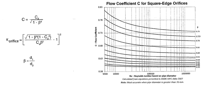

Calculate Korifice by substituting Cd and beta values
See image

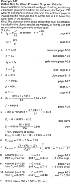

This is taken from Cranes Technical paper 410M problem 7-12. I cant seem to get the Korifice value by substituing the Cd and beta value. For example for beta = 0.7 & C = 0.7, I'm calculating Cd = 0.61 and Korifice = 28.0 (not 4.34 as shown) using excel. Is this an error?
Page A-21. Using Re = 8e5 for relating C and beta
So am I . There must be something wrong in the ##K## expression: the numerators are ##\approx 0.93## denominators ##\approx 0.12##

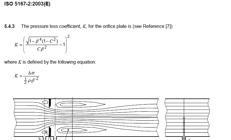

ISO 5167-2:2003, (pdf version pops up first link in google)
pg. 14.. same eq. as in Crane for Korifice...

not a typo, example 7-12:

I got the same result as you in Excel (most current version). I also plugged the equation into WolframAlpha and got the same result (both results for Korifice).
