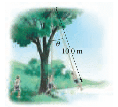

56-kg student runs at grabs a hanging rope,
and swings out over a lake (Fig. 45). He releases the
rope when his velocity
is zero. (a) What is the angle when he releases the rope? (b) What is the tension in the rope just before he releases it? (c) What is the maximum tension in the rope?
##a_n = \frac v^2R
Please tell me if I need to post my solution for this.., but I just have a question more or less 'conceptual' question about (c).
so I know that from Newton's 2nd law for centripetal acceleration --> ##F_{rope} - mgcos(\theta) = ma_n## where ##a_n = \frac {v^2}{R}## such that where the normal acceleration is maximal (i.e. also maximum velocity) is where there's max tension in the rope. But.. how do I find where the velocity is going to be maximum?
I would reason about it in terms of energy that in the beginning of the jump he only has kinetic energy after which ##KE## is changed in ##U_{grav}##. From this I know that the velocity is going to be maximum at the beginning of the jump and thus the tension in the rope as well.
Is this correct reasoning about this or can I look at it in another way?

simphys said:
so I know that from Newton's 2nd law for centripetal acceleration --> ##F_{rope} - mg = ma_n## where ##a_n = \frac {v^2}{R}##
That is not true, it is the component of the weight mg in the direction towards the centre of the circle that is used in the centripetal acceleration

Seems to be some information missing, like how fast was he going when he grabbed the rope?
odd.. my apologies I edited it yesterday.. seems that I didn't save the changes. will do it again.

ok, so using energy conservation write the relationship between the angle and the velocity.
Likes simphys
for part (c) right?
simphys said:
for part (c) right?
yes

Indeed, something seems amiss. 95 km/h is sufficient that to drive a 10 meter rope swing up past top dead center, thus rendering part a) of the question invalid.
simphys said:
He releases the rope when his velocity is zero.
And 35 km/hour seems decidedly different from zero.
Edit: Google says...
[Found on chegg.com]
"A 56 kg student runs at 5.0m/s, grabs a hanging rope, and swings out over a lake (Fig. 45)"
Google also gives a variety of other versions, not all of which contain the "Fig. 45" text along with various other initial velocities such as 5.2 m/s or 6.0 m/s and various other rider masses. The hits found are generally on cheating sites where students go to harvest answers without actually doing the work.

You can start with:
$$\nearrow^+ \sum F_t = -mg \sin \theta = m a_t \implies a_t = -g \sin \theta $$
Then use the kinematic relationship (apparently on valid for uniform circular motion):
$$ \int v \, dv = \int a_t \, ds $$
where ## ds = r d \theta ##
After you do that, you'll end up with ##v^2## ( or ##v##) as a function of ## \theta ##. From that point forward
(1) you can intuit a solution (by judging the size of the terms in the result - where they will make ## v## largest)
or
(2) just set the derivative of that result w.r.t ## \theta = 0## :
$$ \frac{dv}{d \theta} = 0 $$
and solve for ## \theta ## (applying the necessary tests for extremums)
Either method will get you there.
Likes simphys and Delta2
But conservation of energy will get you there on a much shorter (and faster) path.

I am sorry guys... total disaster here. Messed up the problem indeed. aiaiai
