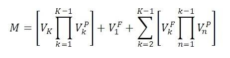

Thanks for the reply. After I posted this I actually worked out a formula, but it's really clunky and I couldn't really say how I derived it. Here's what I have (by the way I'm uploading a JPG for this because I know if I tried to type it in I would screw it up real nice).
Explanation of notation:
M = total number of answer possibilities (number of "paths")
k = 1,...,K is the number of items on the test
V is the total number of answer choices on item k
VkP is the number of passing answers on item k
VkF is the number of failing answers on item k
Hence, VK is the total number of answer choices on the last (Kth) item on the test, and V1F is the number of failing answers on the first item (k = 1) on the test. (And in the last term in the formula, n is used as an arbitrary index.)
Any advice for making this prettier/more efficient?
Thanks!

I did not check all indices, but the formula looks good. I think you can include V_1^F in the last expression, using the convention that an empty product (from n=1 to n=0) is 1.
In the same way, you can include the case "n-1 correct answers and failed at the last one" there, which simplifies the first part a bit.
Great, thanks for the tips!
