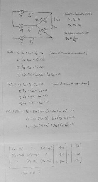

I think your problem here is that if you just do KCL you get a set of 3 equations and 3 unknowns that is singular. This indicates that there is more than one possible solution.
@Baluncore is correct, the line currents SHOULD sum to zero. IRL, check that first, just to verify that your data fits your model. This means that you can ignore one of them, let's say ##I_C## since ##I_C = -(I_A+I_B)##. This will allow you to simplify your model, as I've done below.
My approach would be to use superposition to get a set of equations and work from there. I've started it below, but I'm way too busy today to actually finish it. Let me know how this works out for you.
I think the genesis of the multiplicity is that you could have a circulating current in the loads. Suppose you have a solution to the phase currents. If you just add another constant term to each phase current (with the polarity in my schematic), that would also be a solution, since it would have no effect on the line currents.
So, you could also choose to stipulate the the phase currents sum to zero. This is a more restrictive question than you originally asked (a passive load condition). This would give you a 4th equation to add to KCL. This is really the same as just adding a KVL equation for the only loop in the network. I suspect this is what @Baluncore really meant above. Again, I haven't done it (at least in the last 5 years or so). Let me know if that works.

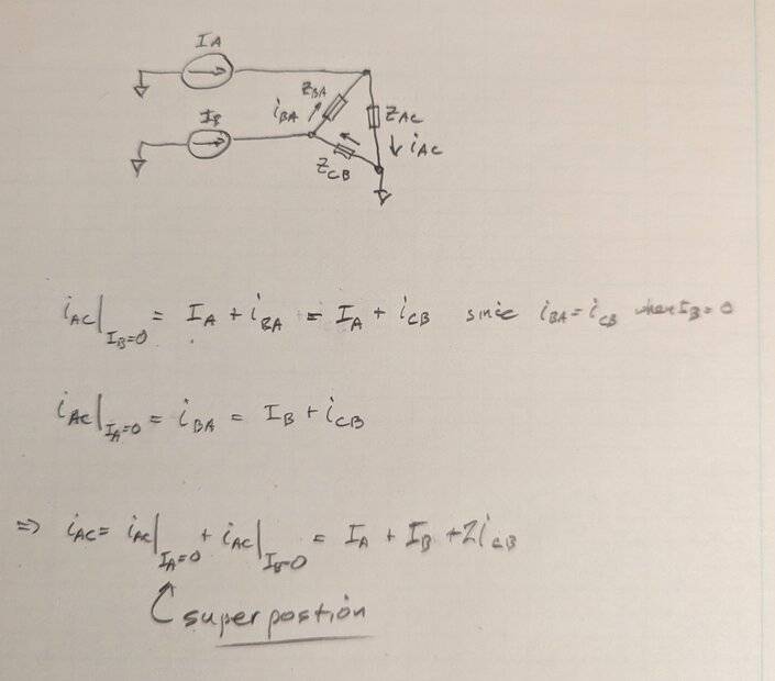

Given these conventions I tried to calculate iba and icb.
But I seem to have taken a wrong step somewhere as my end result is incorrect. I think its already in the first steps:
iba|IA=0 = IB +icb
iba|IB=0 = iac - IA
+= IB +icb + iac - IA
icb|IA=0 = iba -IB
icb|IB=0 = IC - iac -> -IA -IB - iac
+= iba - iac -IA
Referring to the two unlabeled nodes in the schematic of post #3 (it's not too hard to figure out which is which), if you knew the voltage at each, and the impedance of each leg of the delta, would you be able to calculate the current in each phase? Do you know how to calculate the voltage at each node?
I thought the OPs original problem statement was an unbalanced system with known line currents. Of course it's easier if he has more data. I don't think he does in this context.
Your schematic in post #3 showing phase impedances misled me into thinking we were trying to solve a problem where the phase impedances were known.

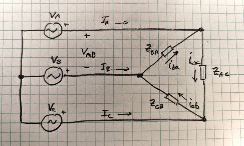

I would use KCL and perform a nodal analysis. You schematic in post #3 is instantly solvable if the 3 impedances are known. The two node voltages are obtained and from those, the 3 phase currents follow.
The 3PH line voltages are assumed fixed in magnitude and phase.
The impedance of the phases are assumed fixed, but unequal.
Each phase impedance is subjected to a differential line voltage.
A vector current flows through each phase.
Those phase current vectors are subtracted to get the line current vectors.
Is the problem here, reversing that process, while not knowing the differing impedances of the different phases ?
yes, I don't know the difference impedances of the different phases.

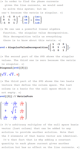

I can recover the minimum norm vector of the phase currents, and in many (even most?) real circuits the circulating currents should be a relatively small fraction of the non-circulating currents. There will be effort in the design and operation of the circuit to minimize circulating currents because they're energy wasters! So it's likely the the minimum norm solution is close to the actual phase currents.
We have an underdetermined system: https://en.wikipedia.org/wiki/Underdetermined_system
The rank of the augmented system is equal to the rank of the coefficient matrix, so the system has an infinitude of solutions. How can we find the one solution out of the infinitude that has the smallest norm (size)?
Use the singular value decomposition (SVD): https://en.wikipedia.org/wiki/Singular_value_decomposition
That article describes how to find the pseudoinverse of the coefficient matrix which I used in post #19 to find the smallest norm solution.
The SVD can also show what can be added to the minimum norm solution to get another solution. In this case our solution be characterized as a 3 element vector. The SVD will give us another 3 element vector such that any multiple of that vector can be added to the minimum norm solution vector, and that result will still satisfy the system.
We can see just from the physics of this circuit that adding equal values to each phase current gives a valid solution. It is to be expected that the math would show that same thing, which we could know from the SVD in some other situation where the physics didn't provide our intuition with the vector whose multiples can be added to any solution vector giving another solution vector.

To save me some typing, lets define ##V_{XY} \equiv -V_{YX} \equiv V_X - V_Y##
Given that ##I_A = -1##, ##I_B = 5##, ##I_C = -4##
We have the solution in post #19 of ##i_{ac}=1##, ##i_{ba}=2##, ##i_{cb}=-3##
Which is claimed to have no circulating currents because of some "minimum norm" argument that I couldn't really follow.
This solution defines the network (for the applied voltages), with ##Z_{AC} = \frac{V_{AC}}{1A}##, etc.
So now, if we add a "circulating current" of ##1A## then for each phase we get ##i_{ac}=2##, ##i_{ba}=3##, ##i_{cb}=-2##.
This defines a different network, ##Z_{AC} = \frac{V_{AC}}{2A}##, etc.
Both examples are unique solutions to KVL and KCL for their network. In particular, they each satisfy KVL for the load loop: ##i_{ba}Z_{BA}+i_{ac}Z_{AC}+i_{cb}Z_{CB}=0##
So, I claim any passive load network can't have steady state circulating currents, because of KVL, even though I don't really know what they are. Please enlighten me with as few words as possible (equations are preferred to minimize my confusion).

The problem is underdetermined (https://en.wikipedia.org/wiki/Underdetermined_system), so the solution for the line currents is not unique; there an infinite number mathematical solutions, but the physics of the situation may rule out some, or all but one.
For example, if we have a vector of phase currents [1,2,-3] and transform that to line currents as I showed in post #19, we get a line current vector of [-1,5,-4] which transforms back to a phase current vector of [1,2,-3].
We can represent the 3 line or phase currents as a vector, for example phase currents [1,2,-3]. This vector has a Euclidean length (norm) of sqrt(1^2+2^2+3^2) = sqrt(14). If we add 1 to each current (this is adding a circulating current of 1) we have another solution, a current vector [2,3,-2], which has length sqrt(17), larger than the norm of the currents with no circulating current. Of all the infinity of solutions for the phase currents with line currents of [-1,5,-4], the one with no circulating current is [1,2,-3], and it has the smallest norm. AND, it is the only one that is physically possible if circulating phase current is impossible.
The same thing applies in the other direction.
Starting with phase currents of [1,2,-3], perform the transformation to line currents.
We get line currents of [-1,5,-4]; add 100 amps in the direction of the delta to each line current. Then we would have line currents of [99,105,96]. These line currents don't add up to zero, so they are physically impossible. But if we premultiply them by the transformation matrix to convert back to phase currents, we get [1,2,-3]; these added currents are ruled out as solutions by the physics of the situation, but they satisfy the math. Knowing only currents (no impedances, that is), the problem is underdetermined, and it has an infinite number of (mathematical) solutions, but all but one are ruled out by the physics of the circuit if circulating current is impossible.
