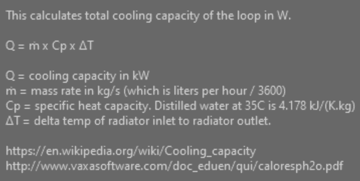

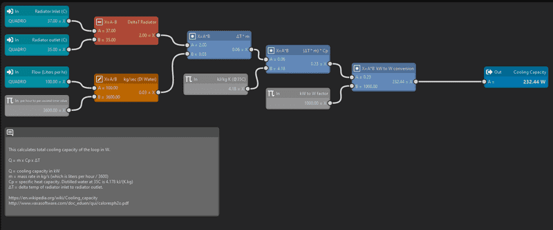

I want some help in figuring out any flaws in these calculations. I was given this picture but I was looking into it and found some things which are either wrong or don't apply to my watercooling loop (for my PC).
First thing I notice is that litres per hour divided by 3600 (hours to minutes) gives units in kg.

The "flowchart" shown is a correct (but cumbersome) way to calculate the cooling capacity based on the simple formula in the gray box, which I enlarge here for clarity:
Note though that the specific figures used there (kg/sec = liters-per-hour/3600 and Cp = 4.178) apply only to distilled water. To use the formula with your cooling fluid, you'll need to contact the manufacturer to obtain the proper values of mass-density and heat-capacity for that particular product.
