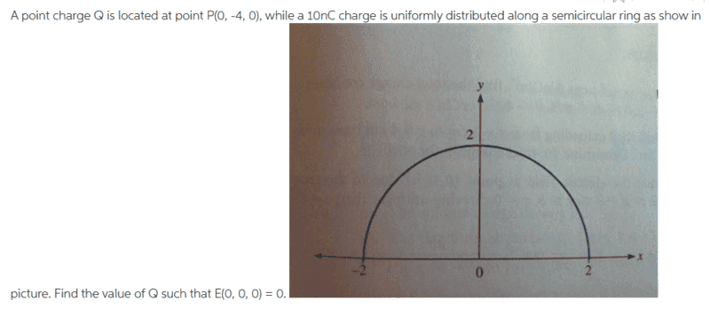

Question
Relevant equation;
My attempt:
Could someone please confirm my answer?
Electric field at the Origin contributed from half ring is of direction - y and its magnitude is expressed by integral
\frac{1}{4 \pi \epsilon_0} \int_0^\pi \frac{\rho r \sin\theta d\theta }{r^2}
where r is radius of half ring, ##\rho## is line density of its charge.
The component radial is cancel out, because of all direction of component radial around circle center
