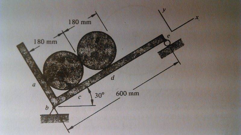

Two cylinders, each with a mass of 10kg, are lying on an L profile.
Neglect the thickness and weight of the L profile.
Calculate the reaction force in b and e.

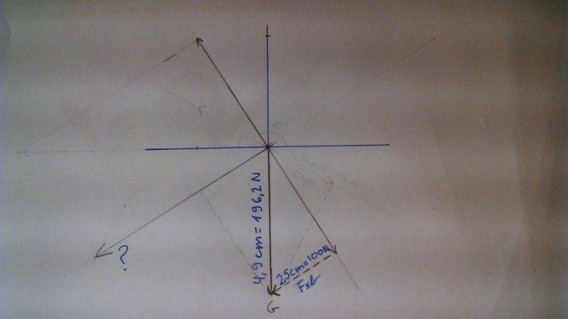

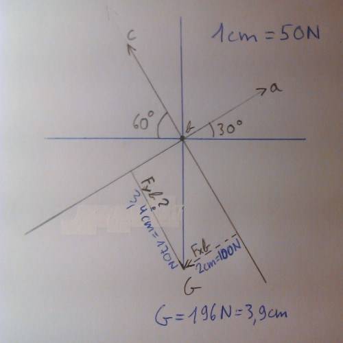

So I tried to make a free body diagram of the cylinders.
I assume their mass is combined, since they are close together.
I took 1 cm = 40N
G = 10*2*9.81 = 196.2 N
I think I found Fxb, but how to find the rest?

The answers on my answer sheet are:
Fxb = 100 N
Fyb = 136.14 N
Fye = 36.96 N

I made a new drawing.
This time is 1 cm = 50N.
I think I found Fxb, not sure, since it came out 100N
1cm = 50N
2cm = 100N
But Fyb is wrong and I don't understand the force on e.

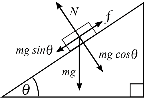

If I follow this
G = m * g
G = 20 * 10 = 200N
N = m * g * cos(30)
N = 20 * 10 * cos(30) = 173.2 N
f = m * g * sin(30)
f = 20 * 10 * sin(30) = 100N
So the X (Fxb) component is right, but why is my Y (Fyb) component wrong?

Since you are combining the masses, you must combine all the forces acting on them. That includes the reaction at e. That provides some of the y force, it does not all come from b.
You need another equation. See my (edited) post #5.

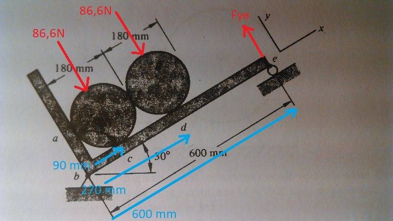

You mean that the force of:
cylinder 1 + cylinder 2 + force on "e" = total force on Y ?
Fcylinder 1 = Fcylinder 2 = m * g * cos(30) = 10 * 10 * cos(30) = 86.6 N
total force on Y = 173.2 N = both cylinders?
What I do is clearly wrong since the force for both cylinders should be less that 86.6 N, otherwise there is no place for Fye.
Of course if I understood correctly what you meant.
I don't know what you mean by "force on Y".
Since you are not asked for the reaction forces at c and d, you can treat the cylinders plus the L piece as a single body.
It is supported by a force at e in the Y direction and forces in both X and Y directions at b.
What balance of forces equation does that give you in the Y direction?
Choose an axis, b or e, for finding moments.
What equation can you write for balance of torques about that axis?

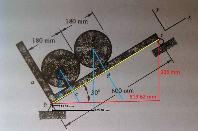

Two cylinders separately: (hypotenuse)
-100N * 0.09m - 100N * 0.27m + Fye * 0.6 = 0
-9Nm - 27Nm + Fye * 0.6m = 0
Ge = 36Nm / 0.6m = 60N
So this is the gravitational force on e?
So to get the normal force on e I need to: 60N * cos(30) = 51.96N
What am I doing wrong?

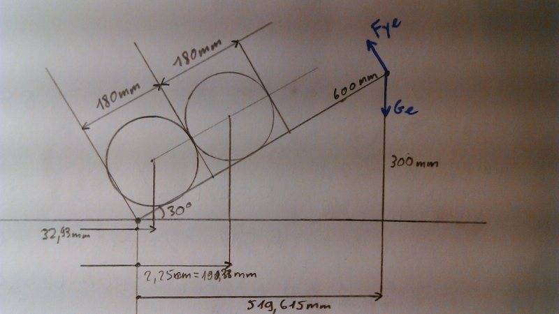

I was wrong to say you could get away with omitting the sin(theta) terms. I was forgetting that your Fye is not vertical.
So let's do this properly. The 100N weights are vertical, but the distances you have used, 0.09m and 0.27m, are not horizontal. For taking moments, you need to use the distance from the axis to the line of action of the force. E.g. what is the horizontal distance from the axis b to the vertical line through the mass centre of the lower cylinder?

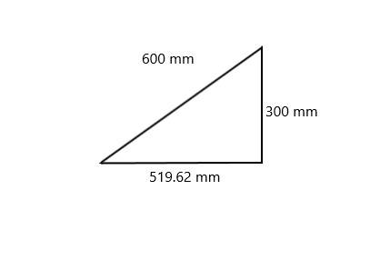

-100N * 0.041m - 100N * 0.205m + Fye * 0.5196m = 0
-4.1 - 20.5 + Ge * 0.5196 = 0
Ge = 24.6 / 0.5196 = 47.34N
Fye = 47.34 * cos(30) = 40.99N
I have the horizontal distance, but I still have it wrong.
Is there something wrong with my equation?

You're missing the contribution from the x component of Fe .
The X coordinate is up the slope. The support at e is a roller, so no force there in the X direction.
I guess you meant the horizontal component.
Epoch said:
Fye * 0.5196m
Why have you changed the distance in this term? The force Fye is perpendicular to the 0.6m distance.
You mean like this then?
-100N * 0.041m - 100N * 0.205m + Fye * 0.6m = 0
-4.1 - 20.5 + Fye * 0.6 = 0
-24.6 + Fye * 0.6 = 0
Fye = 24.6 / 0.6 = 41
But why do I need to use the adjacent for the two forces on the cylinders and the hypotenuse for "e"?
I used 0.5196m for "e" to get the force perpendicular with the adjacent because I was using it for the both cylinders.
Because the force from e is in the y direction, so is normal to the 0.6m from the axis. The two weight forces are in the vertical direction.

I think I figured out my mistake, ignore post #18.

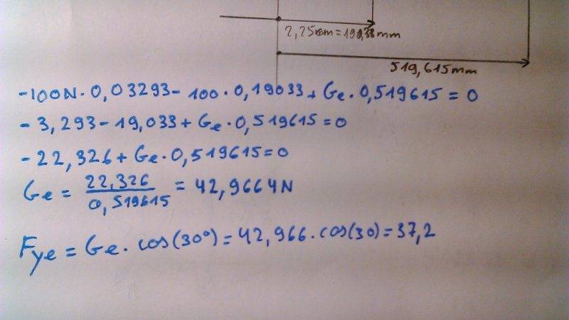

I figured out that my horizontal distances were wrong, I forgot that the L profile width should be neglected.
What you said is totally right, I just did it in 2 steps.
The first time I calculated the G force for both cylinders and e and the took the cosine of Ge = 37.2 N.
Your equation is better since I could have spared a lot of time.
-100N * 0.03293m - 100N * 0.19033m + Fye * 0.6 = 0
-22.326 + Fye * 0.6 = 0
Fye = 22.326 / 0.6 = 37.2N
Fyb = Nforce - Fye = 173.2N - 37.2N = 136N
I think I got it right this time, the only thing is the difference in decimals.
Answer sheet: 36.96 N
My answer: 37.2N
Maybe because I rounded my numbers.

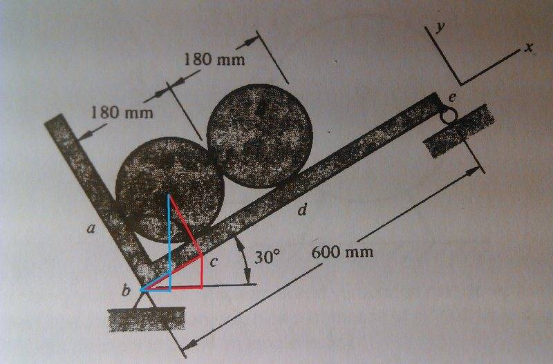

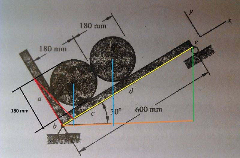

Also I calculated my horizontal distances by measuring with a ruler and putting them up to scale for the drawing.
Example:
The first horizontal distance I measured was 0.45 cm.
The hypotenuse is 7.1cm = 600mm on my drawing.
So I divided 7.1 cm by 0.45cm and got 15.77.
Then I divided 600mm by 15.77 to get the hypotenuse of 38.04mm for my first horizontal distance.
Then I did 38.04 * cos(30) = 32.94 mm, to get the first horizontal distance.
The same applies for the second horizontal distance.
This looks very unprofessional and my question is:
Is there a way to do this properly without measuring?
Yes. What function of an angle in a right angled triangle is the ratio of the adjacent side to the hypotenuse.
That would be the cosine = A / H.
I need for example the blue triangle.
I know the hypotenuse of the red triangle, since 180mm / 2 = 90 mm.
But the hypotenuse of the blue triangle is for me unknown.
At first I was thinking if I can do this:
Since the cylinders are round, their diameter is from all sides the same and since we neglect the width of the L profile I only need to measure the angle of the red triangle and use tan = Opposite / adjacent.
Some more labels...
Call the point on the same horizontal height as b and directly below c point f.
In between b and f, the point below the centre of the lower cylinder is g.
Can you figure out distance fg?
