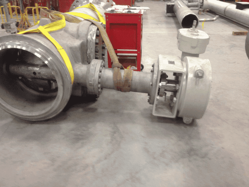

I have been trying to figure out the starting torque needed to start rotating a pipe and valve in a weld fixture. The pipe is 304 stainless 24 inches outside diameter and has an inside diameter of 23.625 inches. The length of pipe varies but so far all of the lengths of pipe get a valve welded on, the valve itself weighs 12000lbs. From the center of the pipe diameter to top of the valve is 78 inches. The total weight of the weldment is 22000lbs but they want to be able to weld weldments that weigh 44000lbs.
The weldment is attached to the gearbox that has a 50:1 ratio and 7HP motor with a VFD, and is supported by pipe roller stands. I am just wondering how do I calculate the torque needed to start rotating a 22000lb object disregarding any losses due to the roller stands.
Any help is greatly appreciated.
You will first need to find the total Moment of Inertia of the combined pipe, valve, weld fixture and gearbox output shaft. The gearbox input shaft and the motor must be treated separately as they have a different angular velocity.
The moment of inertia is the sum of all the constituent masses multiplied by the square of their distance from the axis of rotation. That is easy for most parts but may be difficult for the valve.
If the valve is asymmetric and the axis of rotation is not vertical you will also need to allow for the starting position of the mass imbalance.
Is there a quick and easy way to calculate the moment of inertia and come with with a conservative value for the starting torque needed to spin the piece of pipe and valve?
The customer tells us that the valve weighs 12000lbs total and 6000lbs at top of the valve with is 78 inches from the center of the 24 inch pipe. The total assembly weighs 22000lbs. Any help is greatly appreciated. Thanks to all who reply.

The output shaft of the motor goes to a 7" center distance gearbox with a 50:1 ratio, so when the motor sees all 60Hz the gearbox input is around 1750rpm and the output is 35rpm and 13011 in-lbs of torque. The output of the gearbox goes through another reducer with a 6:1 ratio and gives an output around 5.8rpm. It seems they are using the VFD to get to 2.5 or 3 rpm.
I attempted to calculate the moment of inertia;
Most of the dimensions for the valve are guesses since the piece in question is no longer in the shop.
The valve I=mass(OD^2 +ID^2)/2: with mass in slugs
body,mass 9600lbs = 298.37slugs
I=298.37 ( 26^2+24^2)/2
I=186780lb-sec2/in
Stem, mass 175lbs = 5.44slugs
I=5.44(8^2+6^2)/2
I=272lb-sec2/in
Valve Actuator mass 2225lbs =69.2slugs
I=69.2(20^2+2.5^2)/2
I=14056lb-sec2/in
Valve Total 201108lb-sec2/in
Pipe is 92.6lb per foot
2315lbs = 71.9 slugs
I=71.9(24^2+23.625^2)/2
I=40772lb-sec2/in
Weldment total = 241881lb-sec2/in
Alpha = (Final velocity*2pi/60)/Time
Alpha = (2.5*2pi/60)/3.5seconds
Alpha = 0.0748 rad/sec2
Torque =I*Alpha
T=241881 * 0.0748
T=18092.6 in-lbs
So the 18092 would be my required starting torque?
All of the VFD talk makes me wonder if you turn down the frequency, don't you also lose HP? Thanks everyone for the replies.
The CAD system that was used to design the valve is best placed to integrate the mass by radius squared about the pipe axis. If you know the make and model of the valve you may be able to get the moment of inertia from the manufacturer.
Alternatively build a model using these parts; https://en.wikipedia.org/wiki/List_of_moments_of_inertia
Now that you have found another 6:1 speed reduction, you might consider replacing the motor with a 4 pole = 900 RPM motor for the larger diameter, slower rotating weldments. Depending on VFD programming, that will give you another factor of two in torque for the same power motor.
If you program the VFD as a Soft Starter that will limit the acceleration. You need to program it for maximum safe motor torque during the starting phase. That might mean starting the stalled motor at the supply frequency, but with current limiting.
There can be problems with up-sizing a machine. Gearboxes may break teeth during speed changes under load. They may also lift a foot from the floor and roll the machine over. You should check the torque rating for all the gearboxes and also the security of the floor mountings.
Well designed roller rests may make a difference to operator safety. You should evaluate what will happen if there is a catastrophic mechanical failure of the gear train that immediately locks all rotation. Is the welding up or down, will the machine and weldment then roll onto or away from the operator if the gearbox locks. Or will you just leave that analysis to a Coroner at some future date?
