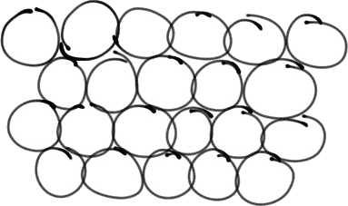

Circles
I'll first derive the density of optimally packed circles on a plane, which is more illustrative and easier to understand, and then I'll proceed to the problem of spheres in space.
Consider an infinite array of optimally-packed identical circles on a plane:
We may trace an (equilateral) triangle with its vertices at the centres of three mutually adjacent circles. If we do this with all the circles, then the (infinite) set of all such triangles covers the entire plane, so the fraction of a single triangle occupied by circle fragments is equal to the fraction of the plane occupied by all the circles. Let us call this the "volume fraction" of the circles and denote it by [itex]f[/itex].
Let [itex]a[/itex] be the radius of the circles and [itex]D=2\,a[/itex] be the length of the triangle's sides.
Because the triangle is equilateral, its angles all equal [itex]\pi/3[/itex] radians. Therefore, the fraction of each circle that lies within the triangle is [itex]1/6[/itex]. The volume fraction is then
[tex]f=3\frac{\pi\,a^2/6}{A_T}=\frac{\pi\,a^2}{2\,A_T},[/tex]where [itex]A_T[/itex] is the triangle's area and the 3 multiplying the first fraction comes from the fact that there are 3 circles which lie at least partially within the triangle.
By Heron's formula,
[tex]A_T=\sqrt{s\,(s-D)^3},[/tex]where [itex]s=3\,D/2[/itex]. Therefore,
[tex]A_T=\sqrt{\frac{3}{2}D\,\left(\frac{3}{2}-1\right)^3\,D^3}=\frac{\sqrt{3}}{4}D^2,[/tex]whereby
[tex]f=\frac{\pi\,a^2}{(\sqrt{3}/2)\,D^2}=\frac{2\,\pi}{\sqrt{3}}\frac{a^2}{D^2}=\frac{\pi}{2\,\sqrt{3}}\approx0.9069.[/tex]
