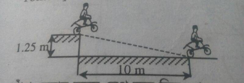

A stuntman jumped from $1.25 \ \text{m}$ height and, landed at distance $10 \ \text{m}$. Find velocity when he jumped. (Take $\text{g}=10 \ ms^{-2}$)
$$h=\frac{1}{2}gt^2$$
I had solved it following way.
$$=>1.25=5\cdot t^2$$
$$=>t=\frac{1}{2}$$
And, $$s=vt$$
$$v=\frac{s}{t}$$
$$=\frac{10 \ m}{\frac{1}{2} \ s}$$
$$=20 \ m/s$$
The answer is correct (checked from book answer). But, $v$ is average speed in the following equation.
$$s=vt$$
But, they told me to find initial velocity. That's why I think my answer is correct but, method is wrong so, the whole work is wrong either.
There's an assumption here that he jumped horizontally.
You've used, perhaps without realising, that the horizontal component of the velocity is constant.
Use those to get the right answer for the right reason!

@PeroK I was trying to find distance of hypotenuse.
$$c=\sqrt{a^2+b^2}$$
$$=\sqrt{10^2 \ m+1.25^2 \ m}$$
$$=10.0778 \ m$$
I was thinking that initial velocity is $$0 \ ms^{-1}$$ since, that stuntman started his bike in initial position. Hence, initial velocity is $$0$$. But, OP says that I have to find initial velocity. How can I find? I was claiming that final velocity is $$0$$. But, If I use $$v^2=u^2+2gh$$ than, I get initial velocity is negative which isn't. So, what should I do with distance of that stuntman was "flying"?
We need to see some vector components of velocity.
Your method is correct and your answer is correct, however it seems to me that you haven't realized some things:
  1. when you write ##s=vt##, s is the horizontal distance and v is the horizontal component of the initial velocity (and it happens to be that the initial velocity has only horizontal component but it could have been different), which does not change through the motion, that's why we can write ##s=vt## after all, this equation is when the velocity is constant (or when the velocity is the average velocity but this is not the case here).
  2. The trajectory of the cyclist will be parabolical. In any case it won't be the hypotenuse (dotted line).
  3. The total velocity of the cyclist during the parabolical trajectory changes both in magnitude and direction, however the horizontal component of the total velocity remains constant. It is the vertical component that keeps changing.

@Istiakshovon let me please ask you something: Why do you think the horizontal component of velocity remains constant through out the motion?
Cause, gravitational force is pulling. 🤔
you need to be more precise than that. Ok gravitational force is pulling so what?
Likes PeroK
gravitational force is pulling and, gravitational force is constant. Hence, horizontal component of velocity remains constant (To my mind, it's not constant completely cause, $v$ is increasing per sec).
Isn't that correct?
Nope its not because gravitational force is constant.
So, that's constant how? :confused:
A velocity component remains constant if the net force in the direction of that component is zero (that is a corollary from Newton's 2nd law). So do we have a net force in the horizontal direction?

yes the vertical force is not zero at all times, not only t=0. It is equal to the gravitational force.

Yes there is force along the hypotenuse, there is a component of the gravitational force along that way. But we usually talk about this component when we have an inclined plane, here we have a different case, and as I told you before the trajectory of the cyclist is not along the hypotenuse.
