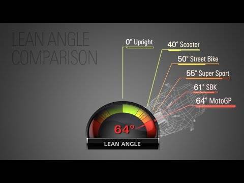

But, the real reason why knee dragging exists is to provide a lean angle gauge. If your body position is consistent from corner to corner, all day long, then you can reliably use your knee as a measuring device.
https://www.ridinginthezone.com/knee-dragging-101/

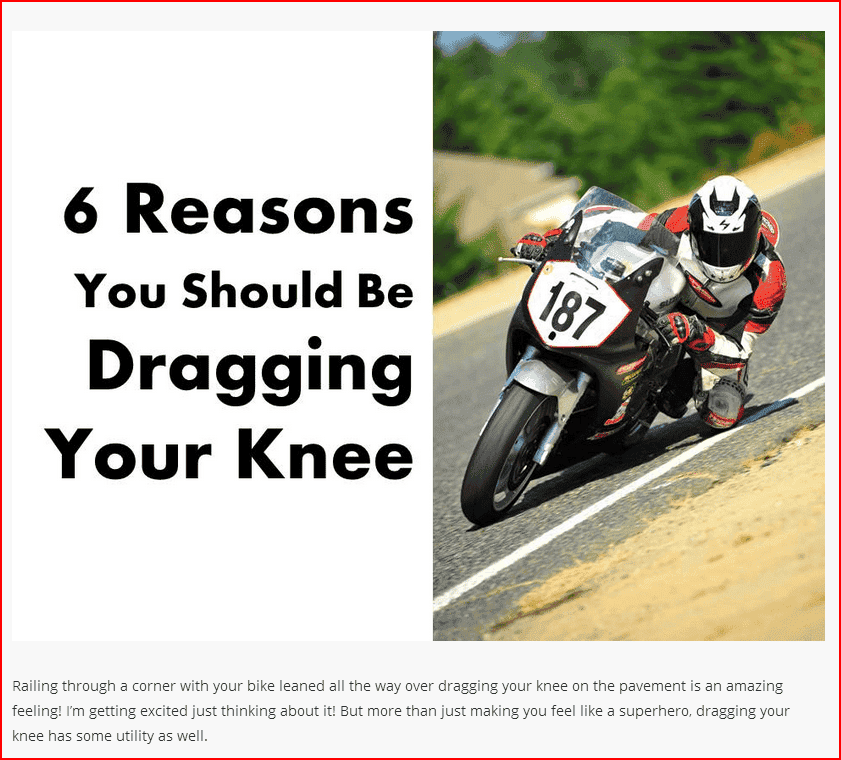

koodawg said:
Summary: Does the rider benefit from putting a knee down by being able to take the corner faster?
So the idea is that, if the rider puts his inside knee down on the ground while in the turn, that corresponding amount of weight is removed from the apparent centrifugal force. So there's a little less centrifugal force so that allow the rider to go a little bit faster then when his knee was not sliding on the ground.

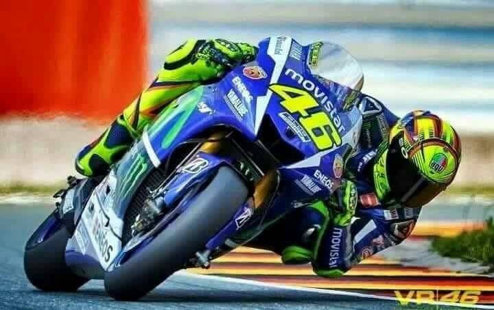

The knee down is a "feeler" to help the rider judge their lean angle. It does nothing for corner speed directly, but helps the rider fine-tune the throttle setting and lean angle.
http://www.cornercarving.com/6-reasons-you-should-be-dragging-your-knee/
244631
Yes, as I stated I understand that there are various reasons riders like to touch their knee down, i.e. to feel their lean angle etc. I intended to make clear that I wasn't interested, for this discussion, in these touchy feely reasons for putting the knee down. What I am interested in, what I am asking for is the actual physics involved in putting a knee down and actually bearing *some* weight on the knee - what happens to the friction and centrifugal forces and russ_watters just gave a great explanation.
Thanks

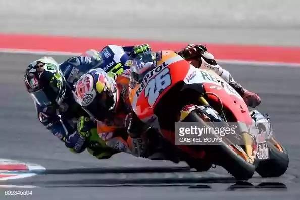

It should be pointed out that riders don't hang out or use their knees as pavement feelers in high speed turns. They stay tucked in. Extreme examples are the two high speed banked turns used at Daytona, or Isle of Mann high speed turns (some at 200 mph). Skip forward to 1:10 into this video:
Likes QuantumQuest, berkeman and gmax137

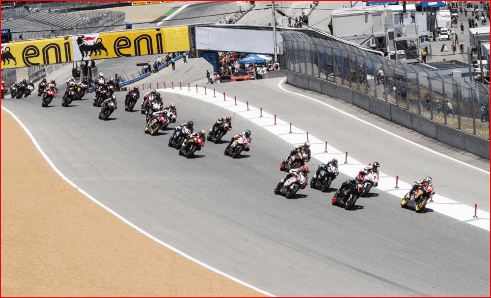

At Laguna Seca, turn 1 is a high speed slight kink, no one is hanging off there. From the start/finish line, the riders don't hang off until the very tight turn 2.
At Isle of Man TT, the riders stay tucked in at 150+ mph, but as speeds decrease below 150 mph, the riders increasingly hang off.

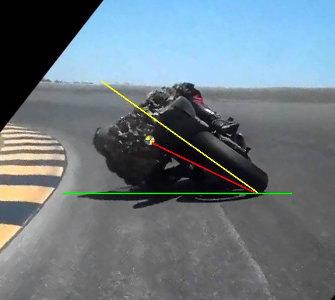

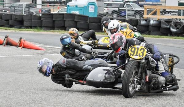

I read the 6 reasons to hang out your knee above in post 6, maybe there is a 7th reason, there should be some down-force , maybe of order 10 to 20 pounds at race speed?
jbriggs444 said:
The ability to corner has little to do with the height of the center of gravity and much to do with lean angle.
Yes, center of gravity has much to do with cutting corners.
When you are turning, the torque caused by two opposing forces (the horizontal component of the weight acting on the center of gravity and the horizontal component of the reacting force to the tires this being not vertical but on the axis joining tip of the tires to CoG as in the case of grip) must be minimized not for the sake of turning itself (always 0 since the bike is in balance) but for the sake of stability.
And the way to do this is by lowering the CoG. The slightest bump of the road or touch of the throttle overturns this balance and the bike turns over. You have to minimize the torque to remain stable that's where the CoG comes into play.
And that's the way the bikers do it in the picture of #18 because "nature cannot be fooled."

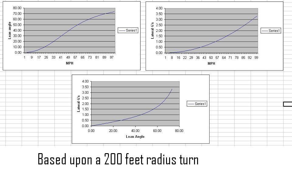

Right. The torque due to weight must match the torque doe to lateral friction, else the bike tips over.
All other things being equal, the torque due to weight is given by the mass times the acceleration of gravity times the distance from the center of gravity to the road surface multiplied by the sine of the lean angle (referencing lean angle to the vertical).
$$\tau_g=mgh \sin\theta$$
The torque due to lateral friction is given by the mass times the lateral acceleration of the bike times the distance from the center of gravity to the road surface multiplied by the cosine of the lean angle.
$$\tau_f=mah \cos\theta$$
Since the two torques must match and since they are oppositely directed, one can equate the two right hand sides and obtain:
$$a = g \tan\theta$$
It's all about the lean angle. How high you stand up on the pedals is irrelevant.
You might be right. I remember watching the Superbike races there many years ago, and I thought I remembered them getting knees down in Turn 1. But looking at Google Images now, it does seem like they do have a knee out a bit, but are not hanging all the way off. You do lift a bit going through Turn 1 (at least I do, but I only got up to about 120mph through that turn at my track days), so staying tucked in through the turn isn't super-important. Braking for Turn 2 starts pretty much as you are leaving Turn 1.
BTW, funny story about those short red marker rods on the left side of Turn 1 (they separate the track from the pit exit lane). The first year we went to watch the Superbike races there, during the first practice several riders kept grazing the rods with their helmets (the rods were taller at first). You can imagine how distracting that is at 140+mph. Before the next practice, the track workers went out and cut all of the rods down to that lower height. LOL :smile:

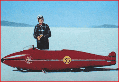

Quasimodo said:
really have no idea what are you talking about here. I googled Bonneville and found no racetrack, and what type of superbikes are you referring to?
They go very fast and (mostly) straight at the Bonneville salt flats. The "racetrack" is a straight line painted on the salt. If you've ever seen the classic movie "On Any Sunday", you'll remember a pretty comical failure to steer one of these "torpedo bikes" at low speeds... :smile:
https://cdn.gearpatrol.com/wp-content/uploads/2017/08/salt-flats-kit-gear-patrol-facebook.jpg

They are called streamliners. Current record was set a few years ago, 376 mph average speed on a flying mile (peak speed 394 mph), two runs (both directions):

As of the streamliners you are talking about, I know nothing about their geometry so I can't comment.

Look again at the picture post #18. The bike can be in a complete upright position and still negotiate the curve!
The torque of a weight put away at a distance from the wheels ( the knee and position of the body of the rider away from the saddle ) generates the extra centripetal force needed for the increased velocity at the apex of the curve.
As I have explained before, if the lean angle of the bike weren't limited by the frame of the motorcycle there wouldn't be any need for this and the turning speed would be as big as you like provided unlimited traction of course.
  • #35
The effective lean angle of that bike (the angle from the tire track to the center of gravity) is not vertical. And it is not even a two-wheeled vehicle. It does not count. Nor do I see a knee extended.
It does not generate any centripetal force at all. It is responsible for a torque due to gravity that can counter the torque from the couple of friction and centrifugal force. Increasing this can allow an extra centripetal force.
The specifications for your claim involved a fixed angular momentum. You cannot increase turning speed by increasing lean angle if you are holding angular momentum fixed. As I already pointed out and as you have failed to grasp.
