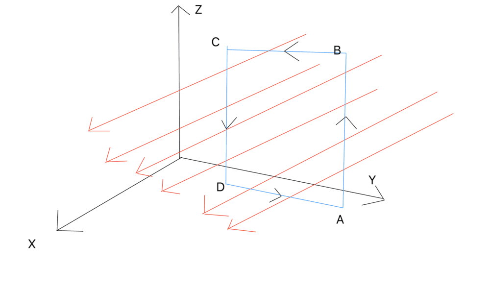

I think I should express myself more clearly. Consider this image in attachment, in the image the red arrows represent the magnetic field B which is given by [itex] \mathbf{B} = B_0 \hat i [/itex] and in the blue square loop a current I is flowing and it's direction is mentioned by the arrows in each arm. The magnetic moment [itex] \mathbf{\mu}[/itex] is aligned with the field.
Now, by Laplace's equation force on each arm is $$ \mathbf{F} = I\mathcal{l} \times \mathbf{B}$$
$$ \mathbf{F_{AB}} = I (\mathbf{AB} \times \mathbf{B}) $$
$$ \mathbf{F_{AB}} = I~a~B_0 \hat j $$ we can assume that our loop is a square with all sides equal to a . Similarly, force on the arm CD is $$ \mathbf{F_{CD}} = - I~a~B_0 \hat j $$
$$ \mathbf{F_{AB}} + \mathbf{F_{CD}} = 0$$ which shows that there is no translational effect as the net force is force (we can do the similar calculations for the arms BC and AD) and the result would that [itex] \mathbf{F_{net}} = 0 [/itex] which is the condition for translational equilibrium.
I request you all to please explain me through an analysis like this.

Adesh said:
the magnetic field B which is given by ##B= B_0 \hat i##
Yes. Since the magnetic field is uniform ##\nabla(\vec \mu \cdot \vec B)=0##. If the field is not uniform then the forces on the different sides of the loop do not cancel out and there is a net translation force.
Likes Adesh
Wow, I took a lot of time just understanding this thing. Thank you.
