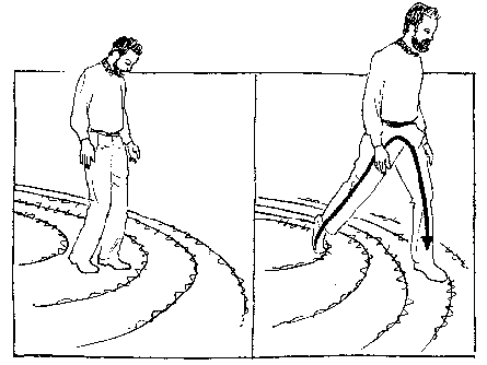

Just to make sure we are talking about the same thing (could be these are different sides of the same coin). My understanding was always that the step voltages are not induced (that is, they have nothing to do with existence of the loop), they are just because two points on the ground are at different voltage. The simplest explanation being that if the point where the lightning strikes has some potential, and the ground has some resistance, voltage of the surface points around changes with IR, the further from the strike we are the lower the potential. Something like that:
and that:
http://en.wikipedia.org/wiki/Earth_potential_rise
(sorry if I am talking about obvious things, I am just not convinced we refer to the same effect).

Ahhh Thanks ! I mis-understood your meaning of step to mean a step function 1/s ...
We surmised it was induction in that loop, though earth potential drop between the separate ground rods some distance apart couldn't be ruled out.
your 'step' was my 'earth potential drop'.
The conclusion was it was one or a combination of the two effects.
