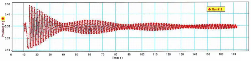

Hello dear members
we know that force exert on spring as a result spring will oscillate many times , i want to know that is there any possibility that spiral spring or conical spring oscillate like 500 times with only one time external force , any one have made this kind of invention in past 200 years
Thank you

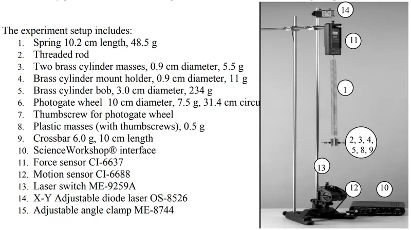

I think this can be accomplished quite easily. Here's a reference:
https://faraday.physics.utoronto.ca/IYearLab/Wilberforce Pendulum.pdf
that describes a lab experiment with a Wilberforce Pendulum; i.e., a mass-spring system that oscillates both linearly and torsionally:
Here are the results of one experiment:
After the starting force, I estimate that this graph depicts at least 150 oscillations before the graph cuts-off. So by optimizing the spring's material and design so as to minimize the internal energy dissipation due to the spring flexing, and by running the experiment in vacuum to eliminate air resistance, it should be pretty straightforward to observe 500 or more oscillations.
