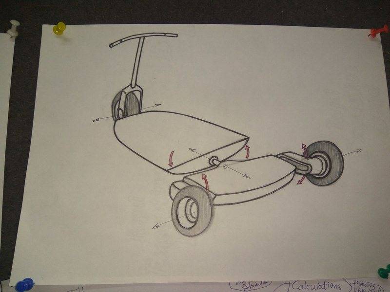

Are you familiar with tilting vehicles. The above image is what I plan to make. For the rear wheels , they can have any form of suspension such as swing arms/trailing arm, double wish bone etc. But for tilting the frame/seat vs the rear wheels I need to have pivot point. I want to add a return back action (that is the vehicle straights itself when unloaded). Best case would be to add a torsion spring, that deforms both clockwise and anti-clockwise. In case I don't get a torsion spring of the right size/stiffness I can try adding regular axial spring.
Here are the problems:
1) Except your reply to a different thread on PF, I have yet to see a spring that would be in tension and compression. The diagram/mechanism is beautiful. Are there actual bidirectional springs available commercially or is it your design. It does not look too difficult to make but yes getting all fits right will be expensive//difficult for me.
2) Are torsion springs also unidirectional only?
3) I need something around 5000 - 6000 Nmm/degree (note the above image is an early concept image that was readily available/clean, the tilting is a different mechanism that also makes sure the rear wheels tilt as well).
4)Will adding two compression spring (that are already preloaded/compressed) on opposite sides of an arm which is pivoted centrally sort of work similar? This was my initial idea and someone on a different thread on PF also suggested the same to someone else.
Any tips or recommendation on the above. I need something that is a quick fix, because I will be trying different springs stiffness for adjusting comfort level. An adjustable torsion spring would be great.

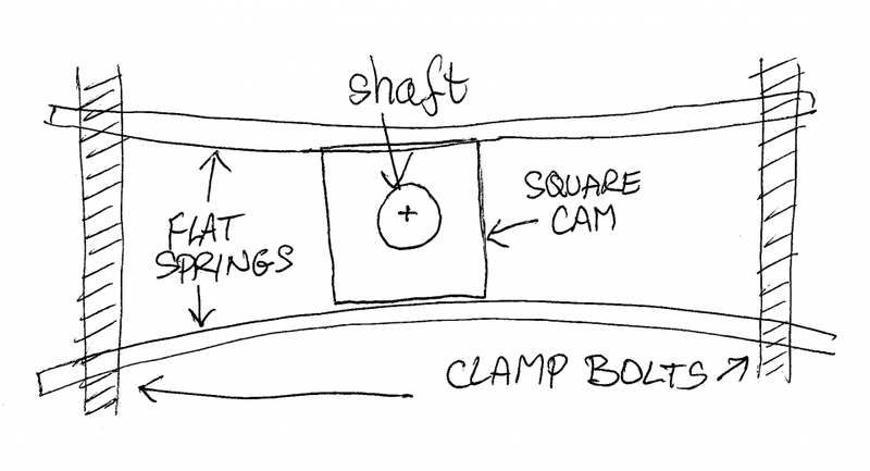

2. Torsion can be done the same way. See attached picture where a square cam is pinched between two flat leaf springs. The cam profile sets the restoring torque to angle relationship.
3. Choose the leaf spring thickness, length and cam to set initial torque to move.

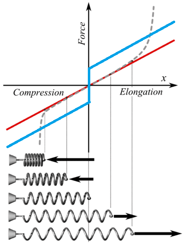

Attached is the original picture from wikipedia, edited to show the special response in blue.
As I understand it, you want the blue line response which has an accurate zero return position.
Any normal springs in series or parallel will have the red line response with a soft zero return position.
If you use two separate springs for the two separate directions, you must calibrate the break-point force and the spring rate to make the diagram symmetrical. That would be difficult for springs with different diameters.

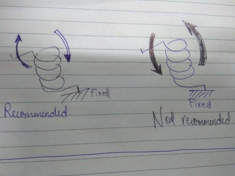

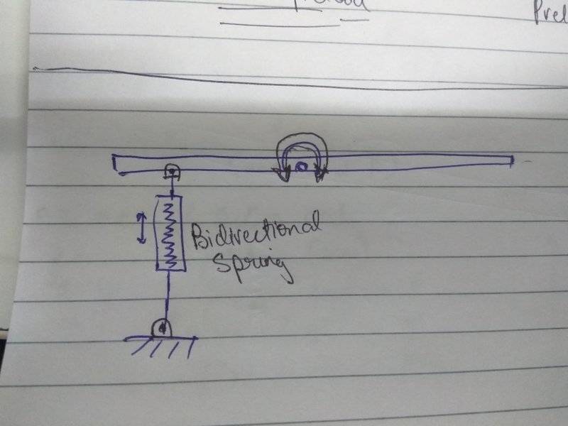

Thank you for your reply. Can you please tell me why exactly a torsion coil spring cannot be used in both directions? Check image spring 4. There are so many guidelines that suggest not to use torsion coil spring in uncoiling direction. What happens if we do? Both short term and long term usage.

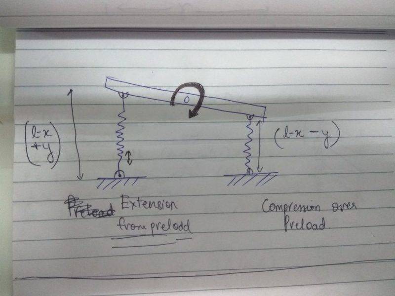

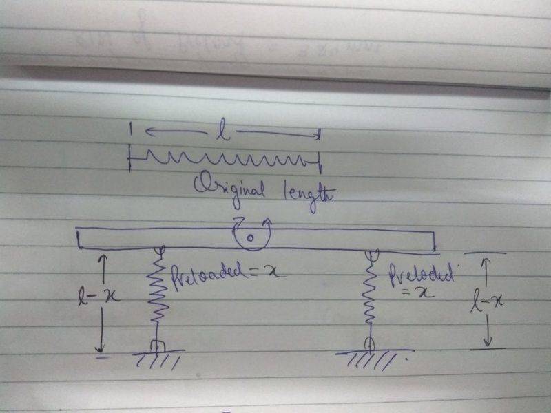

Assuming Torsion spring is not an option here is what I plan to do.
Look at image spring 1: The springs are installed in preloaded compressed condition. But once attached properly, preload will be released (the nut stopping it will be loosened). Hence each spring will try to reach its free length. However it will still be preloaded/compressed due to each spring trying to push the other. When the vehicle is tilted (clockwise as shown in image spring 2), one spring will compress even more, other will decompress (limited upto amount initial preloaded compression)
Will the above work? Challenge will be to balance them well at the time of initial release of preload.
Check image spring 3: Just use a bidirectional spring (same as you have mentioned in different thread). Difficult to manufacture but should work in principle.
Thank you so much for your guidance.

On image spring 3: An airspring can also be used I guess (similar to one normally used on the boot/rear door of a hatchback/SUV/miniwan
I believe the problem is one of “column stability”, a long thin wire will be more stable in tension than in compression as it would kink.
Your spring1 method will not have a step in force at the zero position. The handle of the scooter is a vertical pendulum. Without the stable zero position, it will be floppy and always fall obviously, to one side of zero.
If you find a few pairs of springs or rubber bands to play with, you will quickly develop an understanding of the limitations and possibilities of springs in series.
Spring3 would work. But to fit it within the body you need to mount the mechanism horizontally with a very short vertical lever arm. With the short lever arm and only one spring, the high side forces on the shaft will be asymmetrical, so it will wear faster. Extending the design to symmetrical balanced forces, quickly approaches the conceptual square cam between two leaf springs. Optimising that square cam will define the force versus displacement response. To reduce friction and lubrication requirements, the square cam could be made from two standard ball bearings, one on each side of the shaft, between the leaf springs.
Two air springs would need to be mounted next to each other in a subtractive mode. Again it becomes two close fulcrums on a short lever with high forces.
There is the possibility that the two board parts could slide apart along the pin, pulled close together by a spring. The profile of the junction of the two parts where they meet will give the stability at zero. If the design has the scissor or shears shown, it could injure a rider or bend the shaft. By having a tension spring, the gap could widen to reduce injury and damage possibilities.

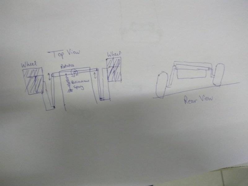

Hi Baluncore,
I actually head changed the tilt mechanism a bit. Though concept of having a spring remained the same.
For your info, the bidirectional spring by itself did work.
But in my system it did not work as intended.
Firstly you were right about having a step in force at zero position. That was partially solved by adding some preload in the spring.
Secondly, even though one could clearly see that the system works in both directions, the response was sadly not the same in both directions. Low fulcrum length, asymmetric fulcrum, could be causes.
The spring also started showing hysteresis (no one told me a spring has to be hardened, not even the spring manufacturer). The spring started deforming permanently (I don't know if that was typical plastic deformation similar to say a steel scale/ruler being bent permanently).
Anyway, thank you so much for your advice. I am trying to upload pictures but for some reason I can't right now. I will most them later.
Above is mechanism in the video is quite similar to what I have made.
Here is a rough sketch. Don't know if you can understand it.
