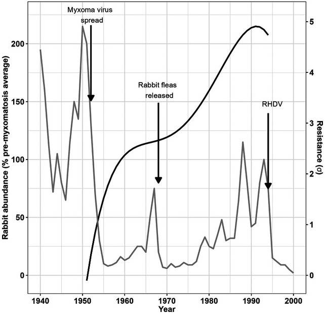

bhobba said:
Myxomatosis has done a good job.
Really? Maybe, sort of...
An external file that holds a picture, illustration, etc.Object name is S0950268823001668_fig3.jpg
Figure 3.
Rabbit population size in relation to rabbit resistance to myxomatosis.
The build-up of resistance to myxomatosis in wild rabbits in Australia (solid black line) explains the partial recovery of the rabbit population (grey line) following the initial introduction of the myxoma virus and the subsequent introduction of European rabbit fleas before the introduction of rabbit haemorrhagic disease virus (RHDV) again reduced rabbit abundance.
https://www.ncbi.nlm.nih.gov/pmc/articles/PMC10644057/#:~:text=Resistance increased in association with,resistance became common after 1975.
Likes bhobba
  • #37
Yikes, way off topic now...
Likes russ_watters and bhobba
