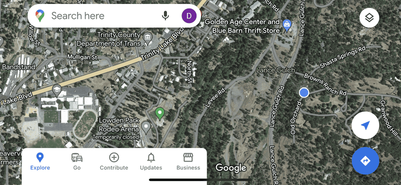

I was in Weaverville, CA on 6/12/22 at about 12:17pm when my business client noticed a strange object in the sky. I filmed it several times over the course of about the next hour. Video initially shoot looking towards NNW.

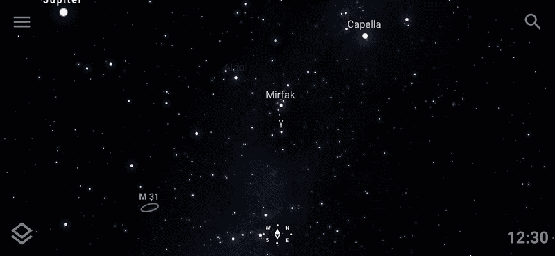

Location, Pointing Direction & Stellar background in direction of object at the time:

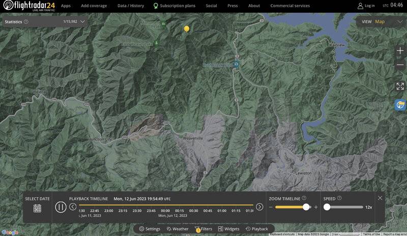

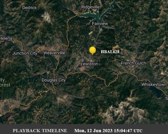

Free access to FlightRadar24 shows that HBAL628 left Northern California about a week ago, flying just south of the Oregon border. Identification is much easier if you log in while observing the flight or the object.
https://www.flightradar24.com/HBAL628/306cca05
Playback of the flight shows it visited Weaverville on Mon, 12 Jun 2023 at about 15:05 UTC. I would call that a positive ID without converting timezones.
Aircraft tracking apps like FlightAware and FlightRadar24 now do quite well, but have limited functionality and get confused by flights that just keep on going and refuse to land after a few days.

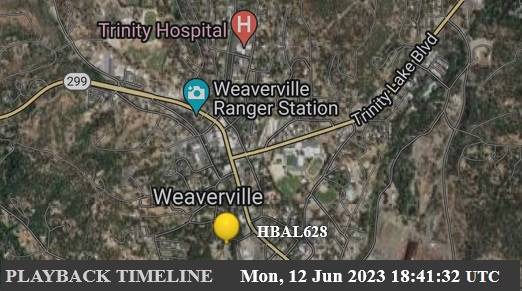

A few hours later at 1842 UTC, HBAL628 drifted north again, this time right over the centre of Weaverville. That fits the video record better.
