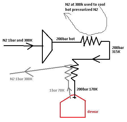

Please provide a flow diagram.
Hi. Is this what you required?
Yes. I'll redo the calculation my own way and see what I get.
According to the TS diagram, you're going to have to cool it to, at most, 160K in order to get any kind of liquid forming. At this inlet temperature, about 15% of the n2 would condense, and 85 % would remain vapor. From the TS diagram, the change in enthalpy of heating this vapor from 78 K to 300 K would be about 245 kJ/kg. (Where did you get your heat capacities from?) But you would only have a mass flow rate to heat that is 85% of the mass flow rate being cooled.
Try the calculation again and see if you can get closure on the energy balances with the 160K temperature entering the flash.
Chestermiller,
You are correct. Any formation of liquid will reduce amount cold gas leaving the dewar, thus making incoming gas hotter, which will again yield less liquid.
The thing is, I have already done calculations for 15% liquid formation, and there is not enough cold gas to cool incoming 315k gas to 160K. So I was forced to assume a higher 170K leaving hex, which is stable but yields almost no liquid. And these calculations show that hampson-linda cycle impractical/ very uneconomical for producing liquid n2 or air, maybe only for demostrations purposes. Even considering oxygens higher 90K boiling point present in air, better yield yes, but still impractical. For simplicity I assumed air to be of only nitrogen.

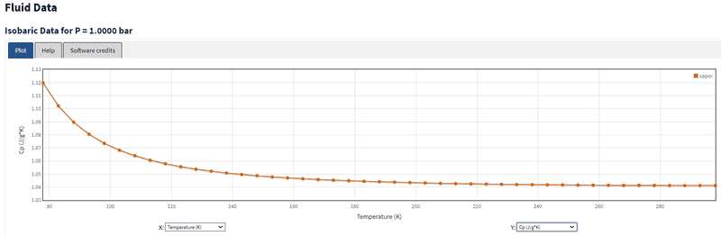

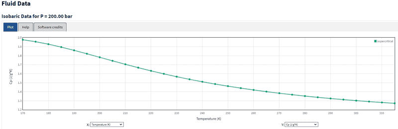

Heat capacities I got from nist website and sharing here now below.
