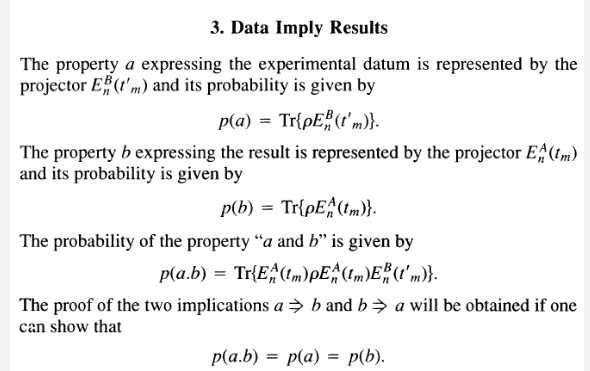

I think I now agree that a POVM cannot be replaced with a projective measurement on a larger system without losing some of the advantages of the POVM approach. At most, if you present me with a scenario where a detector responds to sources, modeled by a POVM, I can present to you an equivalent scenario where a researcher responds to the detector, and model this "researcher response" with a PVM.
* [edit] - Adding the reference for this: "The Interpretation of Quantum Mechanics" by Roland Omnes

A. Neumaier said:
No. You make fewer assumptions but pretend that essentially the same results follow, without telling why this should be so.
I make fewer explicit assumptions, but the assumptions are implicitly there. That's because I think like physicist, not mathematician, so I try to explain how nature works, not to present a mathematical proof. I don't make explicit assumptions which seem obvious to me from a physical point of view, because I see such details as distraction from really important ideas. But I perfectly understand that you, as a mathematician, don't like this type of reasoning.
