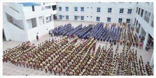

This is my school's assembly area :
The place is generally used for the assembly and various other things. But the problem is that it receives a lot of sunlight and it is difficult to use it during the later part of the day.
So, I would like something like a roof, which doesn't entirely block out sunlight but makes the place a little more comfortable.
One thing I have thought of is installing small nets or rods and then growing creepers on it which would act as a roof. But I am unsure whether this is practical.
P.S. The solution must be cheap and if possible eco-friendly.

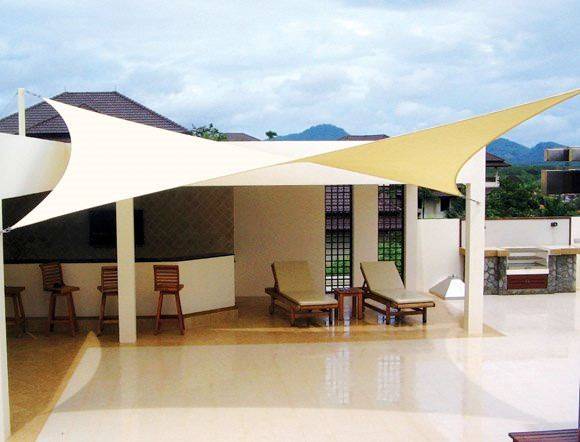

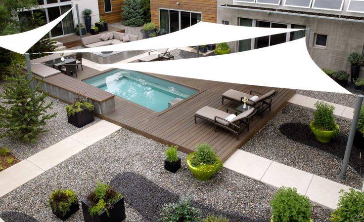

Stuff like these, maybe?
A number of those could be strung between the walls of the courtyard to cover parts or all of the area. Some clever arrangement could give it a nice, modern look with traditional, tent-like vibes. Many small-to-medium-sided ones would be preferable to one huge canvas.
A central pole could be installed to allow for a better coverage and perhaps facilitate a folding mechanism. When not in use it could double up as a flag pole. Or you could just get some longer cables to help cover the mid-section; or even leave it open.
It's easy to draw a few angled triangles over the picture of the area, so you (and your class) could have a go at finding the best, most aesthetically pleasing arrangement.
This seems like a good idea. I don't know why din't think of this. Well, one of the problems with this is erecting poles or pillars is not feasible(or should I say not allowed). It would block the way. Would this work if tied from end to end or maybe along the shorter diagonals?

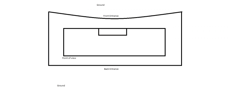

Well, this is a rough sketch of how the place looks from above. The dimensions I am not sure about but must be around 100 m x 30 m. The height of the roof must be at the end of first floor. So, about two floors high.
About the seasonal weather : It's India, so it's usually more on the hotter side. The place is very near to the coast, so it's quite humid too. Summers are very hot, upto 45 C. Moderate monsoons and winters. A bit windy sometimes.

SG2K - you do not think that the sails would work strung from building to building? I am also wondering if these could be made retractable, like a real sail, for high winds or service?
Not from the way the OP has described the problem. As you may recall, the poster fishspawned has stated that given the dimensions of the ground, in order to set up any kind of sails of what you are describing will involve installing posts on the ground between buildings (from the picture there is considerable space between the buildings, approximately 100 feet), but the OP has already stated that installing posts is not allowed, as it blocks the way for students and faculty. Otherwise, my initial idea would have involved attaching sails between buildings, with the ability to retract.
100Ft with steel cable between buildings, root to roof - no post in the ground. Even square rigged(not the triangular ones shown) - and could be peaked ( for rain shedding ) and retractable.

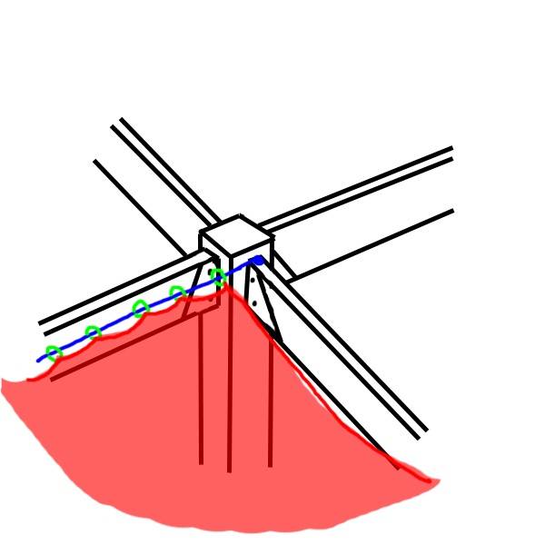

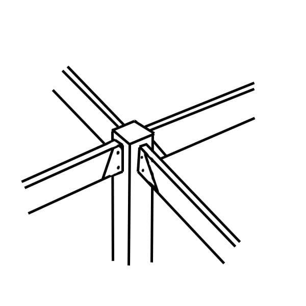

Sorry for not getting back to you sooner, Yashbhatt. I will post the pics here to explain myself anyway, but have to tell you that a large canopy / roof is not feasible. You will have to spend some time convincing the administration to allow posts. May I ask why they do not allow them?
In any case, the post idea would be as follows. A grid of wood posts/beams connected like so:
and then placing a wire line (blue) either side in the direction you would want to move the fabric and the string the fabric along the line, with a simple grommet system.
It would be relatively easy. The wire can be tightened with a tensioner connection. If you build it so that the entire grid work fits within the space with little room around the perimeter, you would not even need to dig the posts into the ground. It would support itself.
