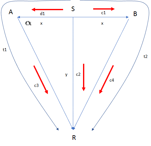

The measurement of the 1 way speed of light is impossible because you use the time between 2 clocks while synchronisation of the 2 clocks is a problem. My idea is to measure it differently by combining 2 measurements: the 2 way speed of light and the measurement under a 90 degrees angle, together with a symmetrical synchronisation of both clocks
The idea is to have 2 clocks at position A and B. The clocks are synchronized by sending a light pulse from position S over 2 equal distances x.
The receiver is at position R at a distance y rectangular to the direction AB and exactly in the middle between A and B and right below S.
for proofing that the 1 way speed of light is always c in every direction we first need to create a situation whare c can vary per direction and then as next step proove based on measurements that this is not possible.
Assuming the light speed is not c but depends on the direction that a light wave travels in space, it is already clear that at least the 2 way speed of light is c.
This means that we can define a lightspeed c1 in the positive x direction and a speed d1 in the negative x direction. It can then easily be derived that the two way speed of light being c, this results in the following relation between c1 and d1:
as we assume the possibiity that c depends on the direction, it is not clear on beforehand what is the speed of light in the direction from the clocks to the receiver R. (speed is c3 and c4 in the figure.)
However it is assumed that the speed of light is at least the same in the same direction. if we could realize that we can measure if the lightpulse to synchronize the clocks needs a different time to come from S to A or B. But to do that we must be sure that the time for the light to come from A to R is the same as from B to R. This can be realized by making y>>x such that AR and BR are supposed to be in parallel effectively giving the same lightspeed . so then this time to get from A and B to R is the same and falls out of the measurement.
so this allows to measure the 1 way speed of light as a combination of equations:
c1=x/deltat1 with deltat1 is the time to come from S to B
d1=x/deltat2 with deltat2 is the time to come from S to A
2x/(deltaT1+deltaT2)=c
2x/(deltaT1-deltaT2)=(c1-d1)
This gives 4 equations with 4 unknown so could be solved.

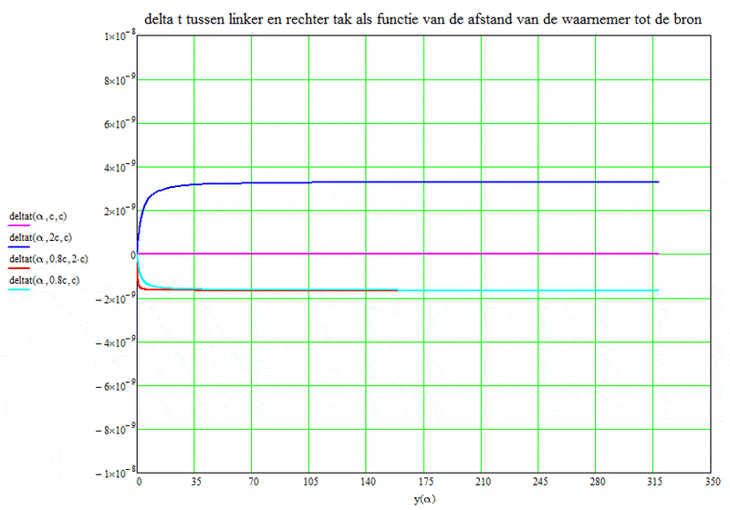

In a separate mathcad sheet I made some calculations based on an assumed relation between the speeds in x and y directions and resulting counterspeeds in -x and -y directions and all speeds in arbitrary directions in between. Based on that I couls calculate the deltaT1-deltaT2 for different angle alpha. (alpha sets the ratio y/x)
next picture shows the result for different speeds in x and y direction (c,2c,0.8C in x direction and c,2c in y direction and linear changeover between speeds for arbitrary directions in between)
x=1 meter and from the picture it follows that for y larger than say 200meter, deltat significantly reaches its final value. so if we measure deltat=0 this prooves that c1=d1=c.
here the mathcad calculation used to make picture above.
This assumption is faulty. While the speeds necessarily tend to the same value as y grows, the distance traveled also increases with y - counteracting the decrease in the difference of speeds. If you do the math correctly, you should find that this is exactly the effect needed to offset the difference in the arrival times at A and B. This is because the one-way speed of light is a coordinate effect from picking a simultaneity convention and therefore not physical.

Thanks a lot for this answer. This sounds like there is a much deeper thought behind this subject than I was aware of. From your answer I understand that you can never find the actual one way speed because you cannot get rid of its components in a direction of base vectors having its effects in other direcitons also so if light goes in 1 direction and finally effectively same distance back in the opposite direciton but via another path it could be that the light does that with speed different than c but you cannot detect that. so than it does not make sense to talk about it either?
There is no possible measurement, no matter how clever, that can measure this. The one way speed of light is just an anisotropic synchronization convention. In other words, it is just a choice of coordinates. No physical measurement can depend on your choice of coordinates, so no physical measurement can depend on the one way speed of light.
