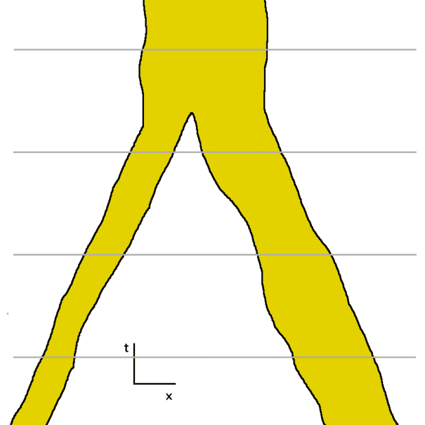

It's worth noting that if you see two black holes that will eventually collide, four dimensionally you are only looking at one black hole. If they won't collide you are looking at two. If you don't have precise measurements you may not be able to tell which it is.
But the same is true of stars. Four dimensionally, if they are going to collide you are just looking at one star. If they collide then you can define a line in spacetime from the interior of one star to the interior of the other without leaving the star by extending it into the future to the merged star, then back into the past through the other star. Here's a rough sketch of a space-time diagram for a head-on collision:
A horizontal line in the diagram represents a 1d section of space at one time (for some not-very-well-defined notion of time). At the bottom of the diagram a section passes through two separate stars (yellow region); as you go up the diagram the space between them gets narrower and narrower until they merge, and at the top you have one large star. But looking at the whole thing, there's only one region of spacetime that is stellar interior. So in a sense there's only one star.
You could draw something similar for merging black holes. But since the event horizon is a structure that only really makes sense to think about in four dimensional terms (it can't be defined without it), you can't really look at the diagram except as a whole - so you always see one black hole with a complicated surface.

I think it is just an essential part of the discussion. looking to the yellow picture above one could discuss about which point at the vertical axis represents the point of no return after which things get per definition deterministic. What I mean is that before a black hole is formed (we start with 2 dust clouds with increasing time) we could in theory influence things to prevent the black hole from forming. But once formed I assume nothing can be done to influence its future. so then it will end up in 1 singularity 'if you see two black holes that will eventually collide, four dimensionally you are only looking at one black hole. If they won't collide you are looking at two. ' so that is deterministic. (perhaps free will is not hte proper description but what I meant is that with free will I could blow the 2 dustclowds away so they never can form a star or a black hole))
