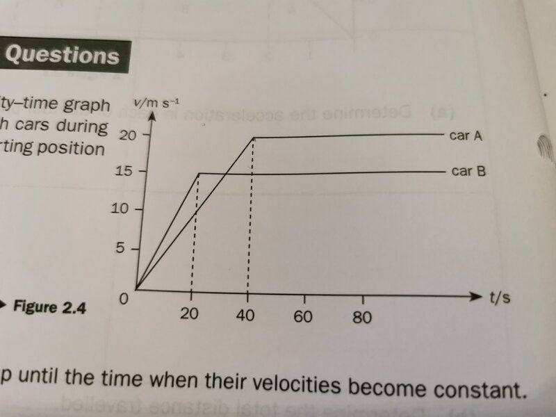

Can you use speed and velocity interchangeably?
  • Thread starter Thread starter ellieee
    Speed Velocity
Speed and velocity are closely related concepts, particularly in one-dimensional motion, where they can often be used interchangeably. Speed refers only to magnitude, while velocity includes direction, which is crucial for understanding motion. In a straight line, if speed is x, velocity can be either x or -x, but this relationship does not apply to other types of motion, such as circular motion. The discussion highlights the importance of accurately interpreting graphs, particularly velocity-time graphs, to determine the nature of the motion. Accurate labeling of such graphs is essential for confirming that the motion is indeed linear.
ellieee
78
qn (di)-> the graph is a v-t graph, so shouldn't we say "constant velocity" instead of "speed"?
nil
Yes. It's better to describe it as constant velocity, as speed just describes the magnitude and not the sign. (I presume this is one-dimensional motion.)
In motion in a straight line such as in your example, the concepts of velocity and speed are almost identical: If speed is x, then velocity will be x or -x. I repeat, this holds only in motion in a straight line, it does not hold for other motions e.g. circular motion.
Delta2 said:
in a straight line
how can you tell it's in a straight line ?
ellieee said:
how can u tell it's in a straight line ?
I can not infer it from the given data (the screenshot of the graph isn't complete, doesn't completely show the text that describes the graph), somehow I thought it was given to you.
Since they label it a velocity-time graph, where the velocity is constant it must be moving in a straight line. (Assuming it's labeled accurately.)
