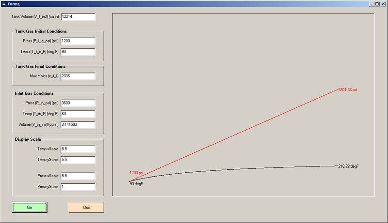

Here is a test run for the ideal case:
I am surprised that the pressure is linear. That is, if the program is running correctly. Overall. the values seem to be in the correct ballpark, considering these are high pressures and outside the ideal gas regime.
The target gas is Methane (CH4).

Are those pound moles or gram moles? What value of gamma did you use? What does the volume of the inlet gas refer to, and why is it equal to pi? What is the abscissa on the plot?
Likes treddie
  • #60
What you see in that image is a quick run before I had made final fixes to the display of information. I went to bed before I could finish things up. To sum up:
"Are those pound moles or gram moles?"
Just gram-moles...Number of moles...6.02 X 10-23 molecules/per mole.
"What value of gamma did you use?"
Gamma = 1.4
"What does the volume of the inlet gas refer to, and why is it equal to pi?"
The two fields referring to volume of inlet gas and inlet pressure are unused...They showed up in the program because I was referring to old notes when I was building the program form, and I was still expecting to use ##(Pv)_{in}## instead of ##T_{in}(C_p - C_v)##. Those fields have now been deleted. Volume was equal to pi because it just happened to coincidentally come out that way. My unit inlet volume was a portion of the supply line enclosing a gas volume, 4" long X 1" dia., at 3600psi, 60 degF and held about .6 mole of molecules. Each one of those volumes would enter the tank at each time step. But with the ##(Pv)_{in}## approach now history, all of that stuff is now irrelevant.
"What is the abscissa on the plot?"
Abscissa is "Moles".
  • #61
I basically confirmed your results, although I worked with volume in ft^3, mass in lb-moles, and R=10.73159.
Note also that your final pressure is higher than the supply line pressure. This is, of course, not possible and means that you won't be able to get as many moles as you think into the tank.

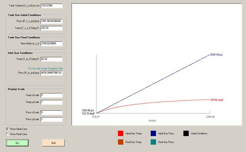

"Note also that your final pressure is higher than the supply line pressure. This is, of course, not possible and means that you won't be able to get as many moles as you think into the tank."
I am assuming that the supply line always has a positive delta pressure over the tank pressure so that moles/time going in remains constant. So if I simply put the same amount of moles into the tank per iteration, I assume that implies a constant delta pressure.
Here is an updated screen:

Now that I am working the Van der Waals case, that Pv term is coming back to bite me. There is no easy way to get it in ##T_{in}## terms. But cannot I simply use the initial conditions for ##(Pv)_{in}## and then let the solution for ##T_f## be an input into the EOS to get tank pressure, then use that tank pressure as the reference for my change in inlet pressure? Since I am making the assumption that since the mole rate into the tank is constant, then the inlet pressure is always a constant ##\Delta P## over the tank pressure? But it seems that does not take into account the changes in inlet pressure between each iteration. Between each mole "chunk" I add to the tank at each iteration, there has been a continuous change in tank and inlet pressures between the moment of the last chunk, and the current one. In that case, it looks like another integral is involved.
  • #64
I don't follow every detail of what you are saying here. But, you can't have a constant pressure difference and, at the same time, have a constant molar flow rate. And, if the pressure in the supply line is increasing with time, you need to specify how that affects the temperature and specific volume of the gas in the supply line.
The easiest, and closest-to-reality, thing to do is hold the conditions in the supply line constant, and specify the relationship between the molar (or mass) flow rate into the tank and the pressure difference between the supply line and the tank (at a given supply line specific volume). Then you could carry out the transient calculation until the tank pressure approaches the supply line pressure. Or, you could do the transient part after you determine the solution to your equations for the conditions inside the tank as a function of the number of moles of supply line gas added, holding the conditions in the supply constant (as you have done in the previous calculations).

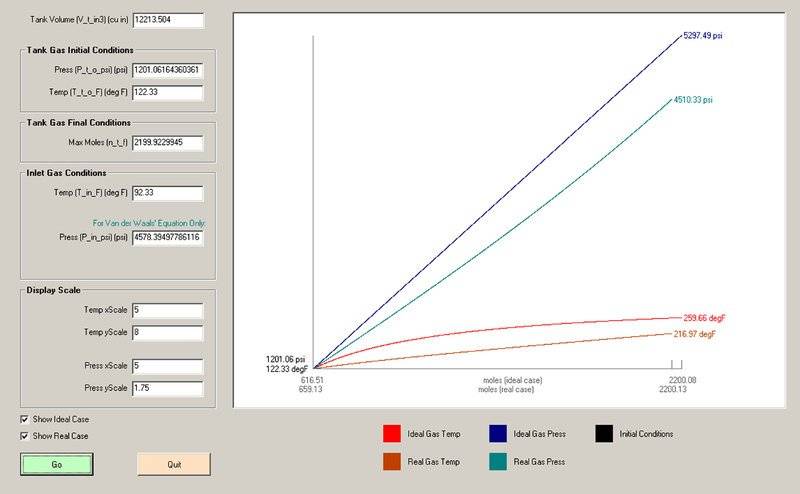

My program must have a problem. I am getting linear pressure change and temperatures that rise sharply and then level off. I need to go over it and look for problems.

Chester,
I just noticed that your graphs disappeared, and some posts from you about a week and a half ago, that I never saw! This is weird.
I am going over your posts from June 5, which for some reason never showed up on my side.
  • #69
In post #66, you have:
##\frac{a}{v_f}-\frac{a}{v_0}=\frac{aV}{v_f}-\frac{aV}{v_0}##
That is not possible unless V only = 1.
  • #70
How did that middle term get in there? Skip that term. It's wrong, and move on to the third equality.

Update:
FINALLY got my code running now. I forgot to switch my VdW constants over to ##ft^3, atm, mol## units. Took me a while to track it down via process of elimination.
At any rate, I find it interesting that the curves for real gas vs. ideal gas show that they are switched relative to which ones are linear. For the real gas, temperature was linear, and pressure rose non-linearly. For the ideal gas, the situation was reversed.
  • #83
treddie said:
True, true.
Update:
It's got to be just a coincidence. Try the calculation with a and b halved and see how the shapes of the curves compare.

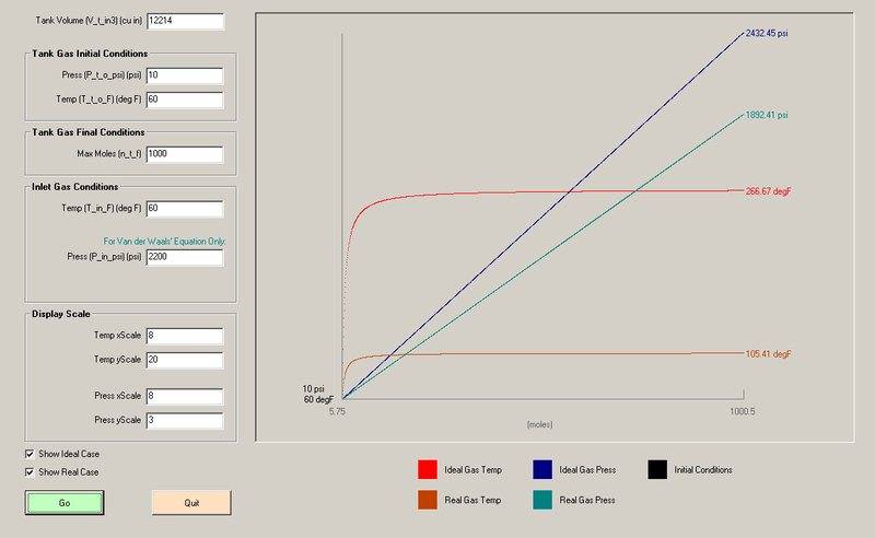

  • #84
You're right:
