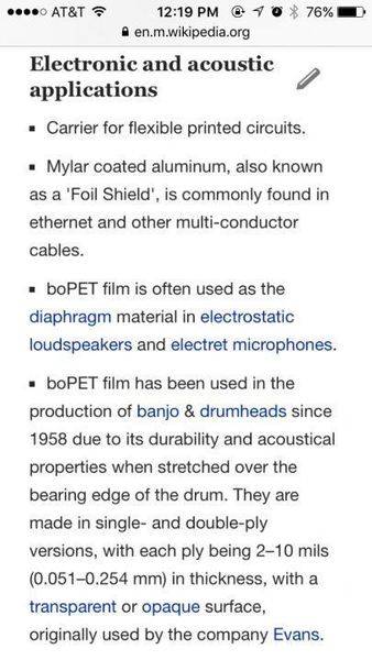

Here's the thing- I have spoken with the percussion specialists at Evans, which is a major company in drumhead manufacture, and they were afraid of the possible "paralysis by analysis" (their words) of enabling the layman to predict the approximate tension on their drums, and thereby select drumheads and tunings based on the 'feel' they want (which is what I am hoping to quantify here- the deflection of the drum, given the radial/uniaxial tension, dimensions, materials science values, and, most importantly, the distance from the membrane center that the deflection originated).
What I find incredibly ironic about this is that Evans is a conglomerate of D'Addario, a major company in the manufacture of strings for musical instruments, and on D'Addario's website they have, for everyone to see, a detailed spreadsheet including what is probably just about every string gauge they sell, and the tension values (at a scale length of 25.5" for guitar, 34" for bass) of an octave's worth of pitches in each string's tuning range. Therefore, what argument do they have that percussionists will experience such a thing? For those, such as Steve Gadd, who have established preferences and methods by which to tune drums, this affects them and their craft in no way, shape or form. This is merely another tool- a tool which can be used to quantify exactly what different players or musical genre prefer.

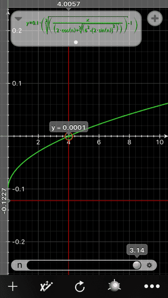

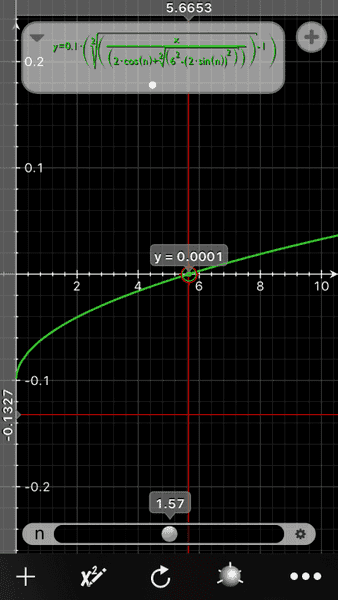

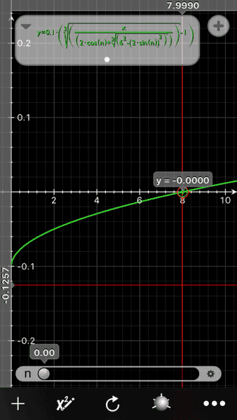

Considering the deformation of the membrane looks similar to the graph
f( x ) = sqrt( x )
revolved about the y-axis (at least when d = 0), I chose to model the deformed membrane as such, where function to be integrated for deformed length, then for deformed area is appropriately scaled by the z-axis deflection, z, and the length L_n .
The vertical scaling can obviously be solved by multiplying f( x ) by z, but I needed a formula which would describe the distance from a point on a circle to any point along its circumference. I found this one in polar coordinates:

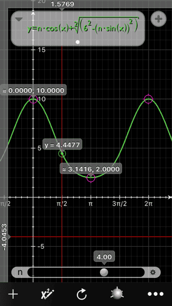

r^2 - 2 ( h cosθ + k sinθ ) r = R^2 - h^2 - k^2
Where 'h' and 'k' are the horizontal and vertical coordinates of the translated circle, and 'R' is the circle's radius.
I then set it as a quadratic equation and solved for 'r' :
r = { - [ 2 ( h cosθ + k sinθ ) ] +/- sqrt[ [ -2 ( h cosθ + k sinθ ) ]^2 - 4 ( h^2 + k^2 - R^2 ) ] } / 2
By setting
k = 0,
r = y,
θ = r,
h = d,
and simplifying, we get the rectangular function:

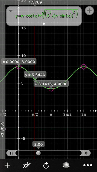

g ( x ) = d cos( x ) + sqrt{ 6^2 - [ d sin( x ) ]^2 }
The composition 'f o g' gives us the formulas for L_{1f} and L_{2f} :
L_{1f}( x ) = z sqrt( x / ( d cosθ + sqrt{ 6^2 - [ d sinθ ]^2 } )
L_{2f}( x ) = z sqrt( x / ( d cos( θ + π ) + sqrt{ 6^2 - [ d sin( θ + π ) ]^2 } )
However, considering g( x ) is a periodic function that doesn't vary in frequency, it becomes possible when integrating for area (which I believe would come after integrating for length) to write something like:
L_f = 2 [integral; 0, π] L_{1f} dθ

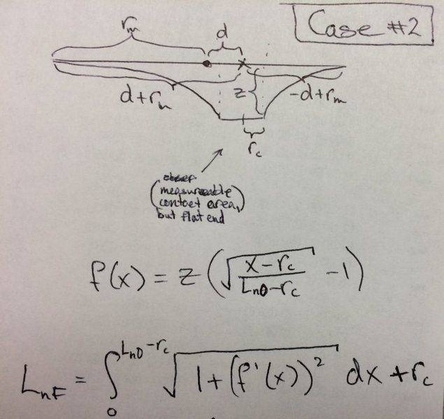

There is a way to take the integral of a 1-D graph such that you obtain the length of the line from f(a) to f(b).
The expression defining the length of the desired portion of the graph is supposed to be more like:
L_nF = [integral; 0, g( θ )] sqrt[ 1 + f'( L_{nf} )^2 ] dx
(Note that the upper bound of the integral is a function, hence the question in #11)
It would be from there that we take the polar(?) integral of the above expression, which, because the 2π periodicity of g( θ ), can be more simply written as:
[integral; 0, π] L_F dθ = 2 [integral; 0, π] [integral; 0, g( θ )] L_{1f} dx dθ = A_f

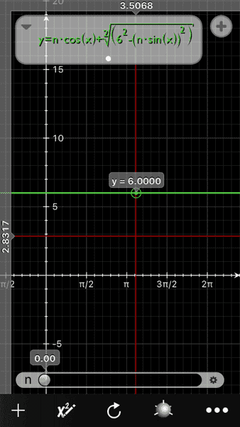

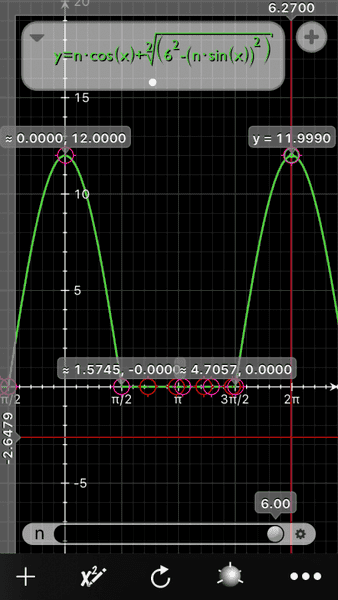

Here are some pictures of the 2-D graphs I mentioned:

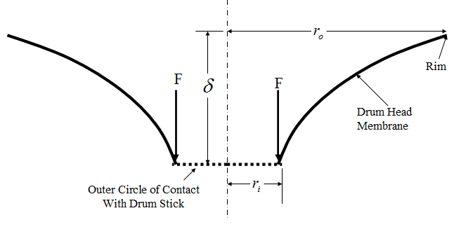

The figure above shows an exaggerated view (not to scale) of the shape of the drum head membrane when a drum stick is pressed vertically downward at the centerline of the drum head. Rather than making point contact with the membrane, the drum stick exhibits a circle of contact at its periphery, as the bottom of the membrane wraps around the bottom of the drum stick. The force of the drum stick pressing down on the drum head membrane is indicated by the force F in the figure, and this force is distributed summetrically around the circle of contact. The depth of penetration of the drum stick is indicated by the symbol δ.
In the analysis I did, I used the following symbols:
##r_i## = radius of outer circle of contact with drum stick
##r_o## = radius of rim
##σ_p## = initial isotropic pre-load stress in membrane, prior to lowering the drum stick
##h## = thickness of membrane
Based on the axisymmetric membrane analysis I did, the force exerted by the drum stick on the membrane (which is equal and opposite to the force exerted by the membrane on the drum stick) is given by:
$$F=\frac{2πσ_ph}{\ln(r_o/r_i)}δ$$
Note that, analogous to a pre-tensioned guitar string subjected to a load at its center, the displacement here is proportional to the applied load. However, the geometric factors are quite different.

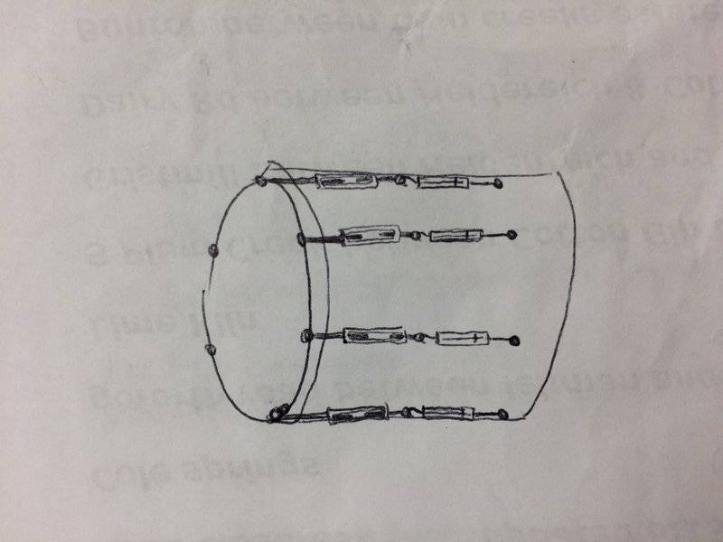

I have designs for a physical apparatus so I check an *aspect* of membrane tension, but it's really just 100lb capacity spring-scales attached to #10-24 thread turnbuckles via short eye-bolts, which are then attached to the tuning bolts of the drumhead (which apparently use #10-24 threads, hence the earlier number) so I can tune it normally and then check my force values. All of this would be mounted to a 14" diameter steel barrel of, which is the typical snare drum diameter.

Chestermiller said:
It is the force per unit area acting on a tiny vertical planar element of area situated within the membrane. If you stretched a square sheet of the drum head membrane material equally in both directions, it would be the force that you would apply at each edge divided by the cross sectional area of the edge. Unfortunately, since, in the actual system, the membrane is circular, it would be difficult (although not impossible) to measure.
Considering this is a circular membrane, meaning it has but one edge, could we not then use something like the surface tension divided by the circumference? Surface tension, at least, is in N/m...
I just realized that the diagram you drew earlier doesn't include the distance--if any--between the center of the membrane and the center of the contact area...
Chrono G. Xay said:
Do you know if the apparatus described above would be able to measure the force per unit area, or would I even be able to compute the force per unit area from the values obtained by such a device?
I am not able to understand the geometry of your setup.
As the second part of my post, my question is if you would be *willing* to do such an analysis. I understand that these things take time–personal time–and you probably have other things of greater importance or things that you might rather be doing than that, though I do not mean to patronize you in mentioning it. If it would mean waiting a few days or even weeks (arguably at the worst), just know that I am more than willing.
I really wouldn't want to do this. At Physics Forums, we are supposed to help you solve your own problem by asking you leading questions and giving you hints. I've already gone way beyond this criterion by providing you with the answer to the case we discussed. My motivation was only to show you how the actual result differed from the result of your analysis.
To comply with the PF guidelines, I would have to wait until you develop significantly more background, so that my hints and leading questions would be meaningful to you. I hope you understand.
The contact problem with a spherical probe would be difficult because of conformability issues. You can't wrap a flat sheet of paper on the surface of a sphere without developing wrinkles in the sheet. So the membrane would have to deform (i.e., strain in-plane) within the contact patch in order to conform to the sphere. This deformation would have to be analyzed. There is also the question of frictional slippage between the membrane and the sphere as the membrane lays on to the contact patch.
I'm confident that I can analyze all this, but then it would feel like I'm back at work again, after retiring.
Chet
  • #31
Yes. That's correct. I assumed that the contact ring on the probe moved vertically downward without causing significant additional stress (over and above the preload stress) in the membrane. That's the same approximation we make when we analyze a preloaded guitar string being loaded transversely.
The rest of the membrane is within the contact patch under the drum stick.
Chet

Here is a sketch of the apparatus:
After a little thought yesterday I realized that, even if still not correct, I could at least somewhat model what you drew earlier, including the distance when the center of the area of contact and the center of the membrane:
  • #34
I understand. I felt nervous asking such a question to begin with, not even remembering the guidelines.
If future questions would fall outside of PF guidelines, please let me know.
I have--what I think is--a conceptual question. Would it not be reasonable to assume that, shape of the implement aside, if we knew the deflection at d=0, that the deflection as one moved away from the center would diminish similar to sqrt( x )?
  • #35
I like the experimental setup. To get the preload stress, you would have to determine the tension on each cable, and divide it by the arc length subtended (1/6 the circumference) and by the thickness of the membrane. This will only give you an approximation to the stress. To get a better approximation, you would need to use smaller arc lengths and more cables.
As far as your equations are concerned, I'm not able to follow what you did and I don't want to spend too much time because I'm pretty sure that they are not correct. But, I have figured out how to complete the analysis that you are interested in and will be presenting it to you later. But, in the spirit of how we do things at Physics Forums, I will only present some of the key initial equations, and then work together with you in deriving the final results. How does that sound?
Chet
