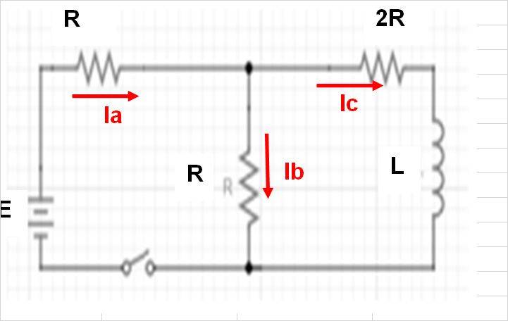

Hi i have this assignment for homework:
There is only one battery for the circuit, E=10V, R=4 Ohms and L=1H
it asks me to find the time constant of the circuit. i know that a time constant in a RL circuit is t=L/R
but i can't find the Rtotal since its in a star direction.
Thanks!
Likes Delta2

There are basically two ways to solve this problem.
1. formal and rigorous approach
Write the system of differential equations for this circuit using Kirchhoff's laws, then simplify the differential equations to find the time constant
2. Fast methods commonly used in engineering
Use Thevenin's theorem to quickly find the equivalent series resistance, and then directly write the time constant.

and in my circuit what is my load resistor?
Treat the inductor as the (Thevenin) load. Show us your working and we will look it over.
(Thevenin's theorem isn't just limited to resistors. Do a bit of background reading/research for yourself - you are at university level now!)

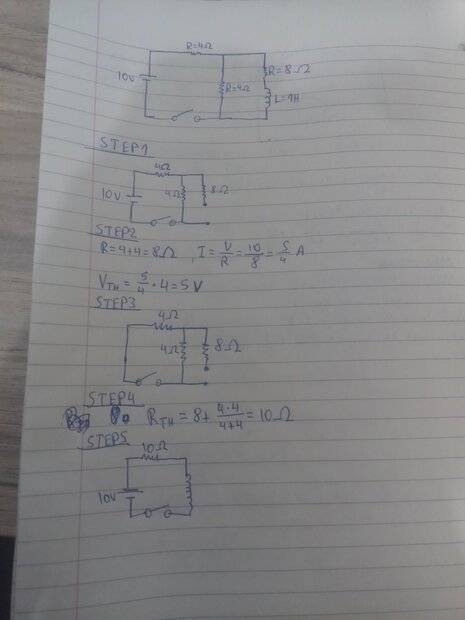

Chrys said:
I've reached till here but i don't know how to continue...
You have correctly calculated the Thevenin voltage as ##V_{Th} = 5V##. (If you used the voltage (potential) divider formula, you could have done it without first finding the current.)
However, you don’t actually need ##V_{Th}## to answer this question!
And note that in your final diagram, you should show the (Thevenin) supply voltage as 5V, not 10V.
You have correctly found the Thevenin resistance to be ##R_{Th} = 10Ω##.
***To find the time constant, you now pretend the circuit is simply a battery, 10Ω resistor and 1H inductor in series.***
What is the standard formula for the time constant of an RL series circuit?
Likes hutchphd
time constant in a RL circuit is t=R/L, in my final circuit the battery should be 5V right?
Yes. Your Thevenin equivalent circuit is a 5V supply, a 10Ω resistor and a 1H inductor all in series. But the voltage is not needed if all you want to do is to find the time constant.
So the time constant is ?
0,1s. Later on in the excersice it asks me to find something else with time=10 time constant, it should be 1s right?
Likes Steve4Physics
Yes and yes.
It's good practice to show all working clearly:
##\tau = \frac L {R_{Th}} = \frac {1H} {10\Omega} = 0.1s##
