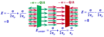

By cap I guess you mean what I would call a plate of the capacitor. I don't know what you mean by the "value of the cap". I guess you mean the capacitance, which depends on the size of the plates, the distance between them and the material between the plates (for parallel plate capacitors, there are also a lot of different types of capacitors).
Let's sya there are two parallel plate capacitors (with air between the plates) in series.
You have
wire - plate - air - plate - wire - plate - air - plate -wire
And you connect this to a battery. If you increase the potential difference applied to the batteries, and you focus on the wire conencting the two capacitors, what happens is that some positive charges will move to one of the plates and and equal amount of negative charge (in absolute value) will flow to the other plate. The net charge of the wire conencting the two capacitors does not change (it remains zero). The distribution of the charges has changed. There is more charge on the two capacitors but if you look at the polarities you will see (say)
positive plate-air-negative plate-wire-positive plate-air-negative plate
That is, the negative plate (cap) of one capacitor is connected to the positive plate of the next capacitor and so on if there are several capacitors.
I am not sure if that adresses your question. I hope.

As the electrons move away from plate 2, plate 2 becomes more and more positive obviously. That means that it gets harder and harder to move electrons away from plate 2 (more positively charged plate 2 is, the more the electrons are attracted by it!).
The key point is that there are two effects: the electrons of plate 1 are repelling the electrons of plate 2, pushing them toward plate 3. But at the same time, thenet positive charge of plate 2 are *attracting* electrosn toward it. Equilibrium is reached when the two effects cancel (that depends on how much charge is accumulated on plate 1, which depends on the capacitance of the first capacitor and on how "strong" the battery is.)
1a) According to Gauss's Law, there is no "net" charge stored inside a conductor when in equilibrium and there is no electric field inside a conductor when in equilibrium. Also, all "net" charge must reside on the surface of a conductor when in equilibrium. So in the case of plate2 - wire2-plate3 region (which is a conductor), plate3 must borrow more additional electrons when Vsupply is increased. Is it borrowing the additional electrons from the surface of plate2 or from within the wire2?
Well, it would be hard to follow individual electrons so it's hard to say :smile: But what is most likely to be happening is that electrons are pushed away from plate 2 and these push away some nearby electrons which then push away nearby electrons and so on in a domino-type effect.
In which case if it is borrowing more electrons from wire2 then the electrons would not be considered "net" charge, but some other type of charge. Is there a difference? You stated earlier that the "net" charge within the plate2 - wire2-plate3 region is zero.
The net charge is simply= (e times the number of protons - e times the number of electrons). No net charge means that the number of electrons is equal to the number of protons. For an isolate system the net charge can never change. The net charge of the system plate 2+ wire 2+ plate 3 does not change.
2). You stated that the net charge is zero in the plate2 - wire2-plate3 region. However, there is negative charge stored on plate3 and positive charge stored on plate2. I am wondering why this does not create potential difference form plate2 to plate 3? I know that it does not because its a conductive wire in the circuit that has very low resistance. However, I was under that assumption that charge imbalance would create an Efield which would create a voltage drop. Obviously I am wrong, but can you explain?
There is also an E field created by the charges on plate 1. It's the total E field which cancels out, at equilibrium.

Okay...Im going to give this a shot. Someone please correct me if I am wrong.
Here is what I believe happens...
Lets focus on the node in between the two capacitors. So we will look at both plates plus the wire conductor in between.
When the caps are charging we have one plate that basically deposits electrons onto the other plate via the wire conductor.
We still have the same number of charges in the plate-wire-plate system, but the charges are now distributed differently than they were before.
On one plate we have a '+' charge because electrons were removed and on the other plate we have a '-' charge because electrons were "added".
But what about the wire in between? I would imagine that the free electrons in the wire are not evenly distributed along the wire but are displaced the exact opposite of the plates.
In other words, I would assume a higher electron density near the positive plate than near the negative plate. So an opposite electric field is created in the wire so the net field is zero.
Some might object at this point and ask why the electrons don't flow onto the positive plate and replace the charge deficiency there...I would answer that the electric field across the capacitor prevents this from occurring on both capacitors.
So we have four different fields in this situation.
Fields #1 and #2: The two fields across both capacitors repel and attract charges to and from the plates and create a potential energy between the plates. If we put a test charge in this region, it will flow from one point to another.
Fields #3 and #4: These two fields are set up by the charge distributions in between the two capacitors.
Field #3 is the field between the plates caused by the local distribution of extra electrons on one plate and missing electrons on the other plate.
Field #4 is the field created by a non-uniform distribution of charge in the wire conductor and cancels out field 3 such that a test charge placed anywhere in this region will experience no net electric field acting on it.So my short answer is that the reason there is no voltage drop is because the charge distribution in the wire cancels out the electric field created by the charge imbalance. Since there is then no net electric field, there is no voltage drop.
I hope that helps David...this is the best I can do for a quick answer. Someone please correct me if I am way off here.

Let's imagine this circuit. Single capacitor circuit.
BATTneg ***wire*** CAP 1 ******wire*** BATTpos.
If you care to, please try to describe all the Efields in the circuit when the circuit is in equilibrium. From what I understand, the only Net Efield exists from the positive plate to the negative plate of the capacitor. However, there are additional Efields extending out into the wires and such that are canceled out. The attached picture (click to enlarge) shows the Efield of two plates that have positive and negative charge respectively. It shows two Efields going out from both sides of the positively charged plate and shows two Efield coming in from both sides of the negatively charged plate. If shows that on the outsides of each plate that the positive and negative Efields cancel each other, but do not cancel each other between the plates. This to me makes sense. However, this is the case where an opposite Efield from one plate extends passed the outer side of another plate and cancels out the plate to wire Efield of the plate it extended passed. My question is... what happens if we stick a battery across these plates that introduces it own Efield
Could you give me the site where you got that diagram from? Id like to see how they are describing the figure..
Anyway...I think I understand what the E-fields in the figure are and it looks okay to me.
Okay for a single capacitor circuit with a battery connected to it.
A battery is kind of like a capacitor in a way, just that a battery has interal chemistry that maintains the voltage across it while a capacitor does not.
In equilibrium we have an electric field across the battery terminals and an electric field across the capacitor plates. Those two electric fields cancel each other out such that neither the capacitor nor the battery can move any electrons. They are both pushing electrons with equal force, but in opposite directions, within the wire so nothing moves.
Does that make sense?
