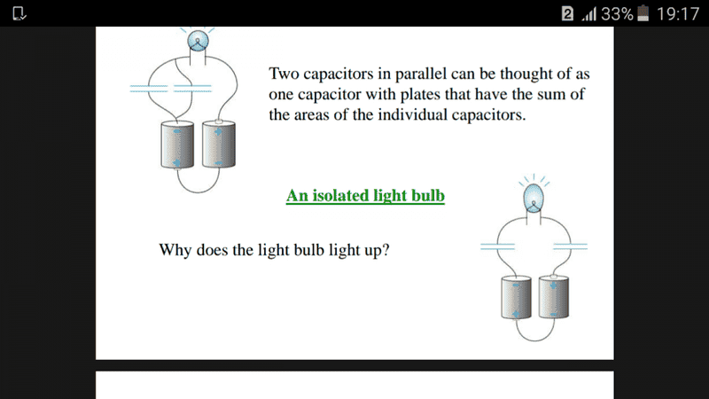

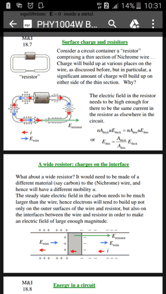

I learned about surface charge feedback theory in electrical circuits a few months ago and it has been extremely helpful for me to intuitively understand many concepts in electrical circuit analysis including conservative and non-conservative fields. I initially referred the paper written by Chabay and Sherwood and later, their famous book "Matter and Interactions" along with some helpful videos on youtube. Here I've attached an image(screenshot) from the book's pdf. As far as surface charges are concerned, I don't understand how the field reaches the light bulb since there are two "breaks" in the circuit. How do the surface charges arrange themselves in order to get the field past the two dielectric barriers and reach the bulb? I can imagine the scenario in case of single capacitor since both of its plates are connected to the source terminals. What happens when there are multiple capacitors is series? Please help me understand this intuitively.
Fields are not limited to conductors. The light bulb has to be at some potential, and no matter what exactly this is, if you feed the circuit with AC current will flow through it.

Thanks for your reply! I understand that there is a voltage across the bulb. But I want to know how exactly the field travels from source to the bulb "through" the dielectric by means of surface charges. The circuit seems to be discontinuous but it isn't as the source voltage reaches the bulb. What is the mechanism here? Would you please elaborate?
When a emf pushes one additional electron to one plate of a capacitor, another electron is pushed off the other plate. So the first plate is now negative, the second, positive. If there is another capacitor in series, it happens again.

Ok. But but even for brief time(say 2s), the bulb will be lit and there will be voltage across it. How will the field travel to the bulb through the dielectric,even for a short time? Suppose the voltage here is V dc. Initially, all the voltage i.e.V will be across the bulb. That means the voltage has reached the bulb "through" the dielectric. That's what I want to understand in terms of surface charges.
cnh1995 said:
How will the field travel to the bulb through the dielectric, even for a short time?
the capacitor dielectric doesn't stop the electric field. on the contrary, when a capacitor is charged, an electric field is developed within the dielectric between the capacitor plates. regardless of if the dielectric is a physical solid, say ceramic or if it is air or a vacuum. The dielectric will primarily just affect the overall capacitance value of the capacitor.
alw34 hinted at what is happening ... let's look at that again ...
lets look at the basics ...
The electric field travels/propagates around the circuit at near the speed of light. And it is the EMF imparted by the electric field that causes the electron flow.
This is why we don't have to wait for electrons from the battery to reach the bulb and cause it to light up. The electric field causes that to happen almost instantly ( in a small circuit aka short conductors).
so ... when we connect the capacitor and bulb to the battery and complete the circuit, there is a movement of electrons from the negative battery terminal towards the capacitor ( in your diag.). For EVERY electron that moves onto the first plat of the cap, one moves off the opposite plate and towards the bulb.
This results in the first plate becoming negatively charged and the other plate becoming positively charged. This continues till the voltage across the capacitor equals the battery voltage.
NOTE: because of the one electron on = one off, the net charge on the capacitor is always zero.
OK so for this very brief time, there are electrons being forced off the second plate and through the bulb and back to the positive terminal of the battery.
Again, for every electron that leaves the second plate, one electron enters the positive battery terminal

What you explained is indeed true and I understand it. Consider a resistor connected across a battery. Here also, initially voltage across the resistor is 0. Within nanoseconds, the surface charges build up across the resistor till the field everywhere on the circuit is same, to ensure the same current. Now, during this initial nanosecond period, the elctrons travel through the wire and sufrace charges are built up across the resistor. After that, the actual steady current starts which is same throughout the circuit as alw43 said. What you explained is this current that starts after the surface charge builds up across the bulb.
You have the arrangement above. The capacitor is charged, then the switch is closed. There is a potential difference across the capacitor, but the same potential difference is across the open switch. So there is some electric field between the ends of it, When the switch gets closed, that electric field effects the electrons in the piece of conductor and they start to move, and an electric field builds up in the whole wire, including the lamp. The potential drops from the + terminal of the capacitor to the negative one also along the wire, and the current flows through the wire, and the capacitor discharges, without any charge carrier crossing the barrier between the capacitor plates.
Thanks for the reply..But here the capacitor is already charged. Discharging mechanism is easier to understand in terms of surface charges.In the original diagram, I want to know how surface charges carry the "information" to the bulb through the dielectrics while charging. The bulb is not conductively connected to the source and still there is a voltage across it (and there should be, I agree). But how do the surface charges carry the signal to the bulb? What happens when they encounter the dielectrics?
I do not follow you. A piece of wire connected to a charged metal, becomes part of a metallic system, and equipotential. The ends of the wire at the switch are at the same potentials as the connected capacitor plates. If you close these ends, the surface electrons start to move, changing electron densities and potential along the wire. The non-equilibrium potential distribution leads to transport of charge all along the wire. The information propagates in the wires, and current flows through the wires instead of through the gap.
Yes..I understand that. I think you are not getting my confusion. Consider the following diagram containing two series capacitors.
