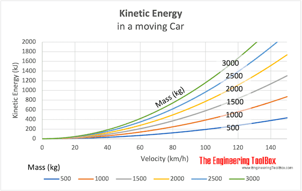

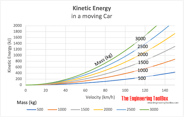

I think it was confusing because of this detail (I now see that you must use u not du ---> P=Fu, as I mentioned in my first post):
A) The graph of Kinetic energy vs velocity wouldn't be a linear graph (it has already been posted). You would need 4 times more kinetic energy to achieve two times higher velocity, with the same acceleration.
B) The graph of Power vs velocity would be linear (P=Fu - for constant acceleration). This means that you would need exactly 2 times more power to achieve two times higher velocity.
C) This is explained because power is the time derivative of energy. i.e: ##P= dE/dt##
Likes Lnewqban
