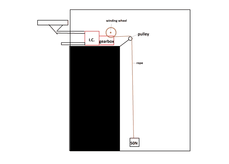

I can set my question in wacuum room.I.C. engine has gerabox which has gear ratios that keep engine full thortlle working allways between 6000rpm-8000rpm when lift weight.
Everthying is set in wacuum room,aero drag don't exist, only 50N of weight and some small constant drag friction force from rope,gearbox and pulley, that don't change with speed..Question will be
1. Why weight acceleration is smaller when weight lift up from 100-200km/h then from 0-100km/h if drag force and weight is unchanged?2.Is L/100km (fuel per unit of distance of weight) same from 0-100 vs 100-200km/h
1.
For what I can see, tension in rope represent thrust for weight.
Logicaly tension in rope will be higher in 1gear then in 6gear,so engine reduce thrust as gears are changed,this I see as reason why weight reduced acceleration when lifitng up..
If rocket with constat thrust pull rope ,acceleration will be the same.
2.
L/100km will be smaller from 100-200km/h
The diagram you show has a constant force device. However, you apparently want to use some gears or pulleys (not shown) so that the "50 N" thrust in first gear becomes, perhaps, a 10 N thrust in fifth gear.
This would not be a completely accurate representation of a constant power device, but adequately close. The rate of descent of the weight would change within each fixed gear ratio. As a result, the power would decrease with each up-shift and then increase until the next up-shift. One would change gears/pulleys to maintain a reasonably constant descent rate for the weight.
Jurgen M said:
1.
Yes, that explanation works.
Let us not talk about rockets until we have wheeled propulsion squared away. Rockets conserve energy too. It is just that you have to look for the energy in different buckets.
Jurgen M said:
2.
Yes.
You mean constant power ?
I.C. engine produce constant power only if you keep it at same rpm, but I assume that from 6000-8000rpm has aprox constant power...
  • #90
You showed a 50 N weight on a string pulling a cart. That is a constant force device. It is not a constant power device.
The faster a weight falls, the faster gravitational potential energy is released and the more power is transmitted by tension in the more rapidly moving string. ##P = \vec{F} \cdot \vec{v}##.
If you are running your engine at max power (and if max power is not at red line), then the rate of change of power with respect to RPM must be zero there. So yes, if 7000 RPM is max power then 6000 to 8000 might be approximately max power.
  • #91
No this not string pulling cart.
Engine/gearbox stay at place and winding wheel lift up weight with rope like cran that has I.C. engine for lifting.Weight is accelerate up.
  • #92
If you have constant 50 N force, it is a constant force device. Period. End Of Story.
Maybe if it was a 5 kg mass, it could be constant power. But it's not 5 kg. It's labeled as 50 N.
  • #93
It has mass of 5kg, on the Earth this aprox 50N, and when accelerate up tension in rope is bigger then 50N...
