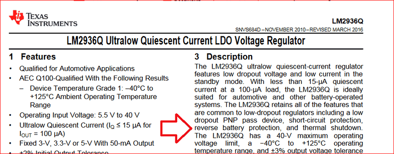

  • #50
nsaspook said:
Even the electronic voltage regulation is slow in response to a 'Load Dump' event. Don't ever, ever, ever disconnect the battery while the alternator is running.
https://en.wikipedia.org/wiki/Load_dump
http://www.littelfuse.com/~/media/e...n_automotive_environment_application_note.pdf
Interesting. I'm not sure I've ever heard of that.
And from the second article, another good reason to make sure your battery connections are tight.
A load dump may result from a battery disconnect resulting from cable corrosion, poor connection or an intentional battery disconnect while the car is still running.

Load dump... worst when the alternator is heavily charging a run down battery. There's a lot of energy stored in the alternator's magnetic field that must go someplace.
That's why better automotive electronics is designed for ~ 200 volt surge.
That's also why one should keep his battery cables in good repair, ie tight and clean. I won't use those replacement cable ends with the wimpy clamps.
attention to the little things keeps the big ones away.

  • #64
Sorry to (slightly) hijack this thread, but does anyone have a comment about jump starting modern cars? I've had advice that ECUs and other units that talk over the CANBUS can be fatally damaged by jump starting. I was advised to 'be careful', but without an explanation of exactly how. Apparently the acceptor car's alternator can produce a voltage surge once started that feeds into the donor car's electronics and buggers them.
I would have thought that A) The acceptor car's alternator would be regulated not to do this, and B) The batteries linked in parallel would buffer any surges effectively.
  • #65
There are two dangers that i know of
one was mentioned earlier in the thread,
when the strong donor battery is connected to the weak acceptor battery only a small current should flow - enough to raise the weak battery to 12.6 volts.
The trouble is, if the cables get hooked backward the strong battery does its best to reverse the polarity of the acceptor electrical system
which applies -12 where +12 belongs
In datasheets for automotive IC's you'll see "reverse polarity protection" mentioned. Manufacturers learned about reverse jumpstarts the hard way.
And about under-the-hood temperatures.
The other is , since garages get a lot of calls in dead of winter when the starter is asked to crank an engine with oil that's thick as molasses,
it used to be common to hook two batteries in series and jump-start with 24 volts which makes the starter really go.
Hence the 40 volt input voltage tolerance on that automotive IC above.
Hint - don't have any lights on when receiving a 24V jumpstart.
But I think the practice is very rare anymore.
