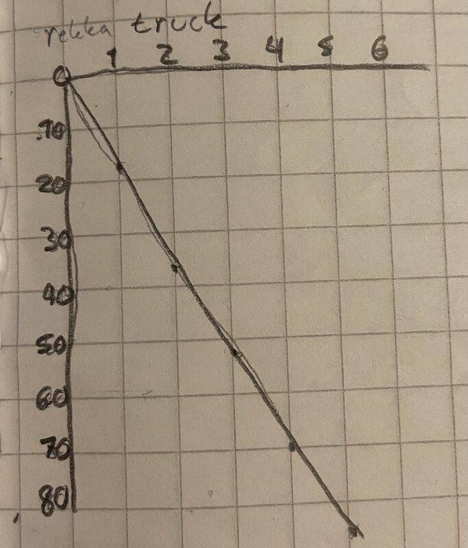

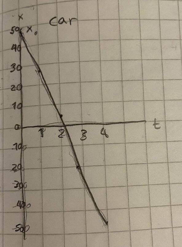

Here are 2 quick graphs i made, please let me know if they are not sufficient :)
I'm not sure those help you very much. The car accelerates for a time, so its distance vs time graph should be curved.
In any case, have you made any progress with the calculations?

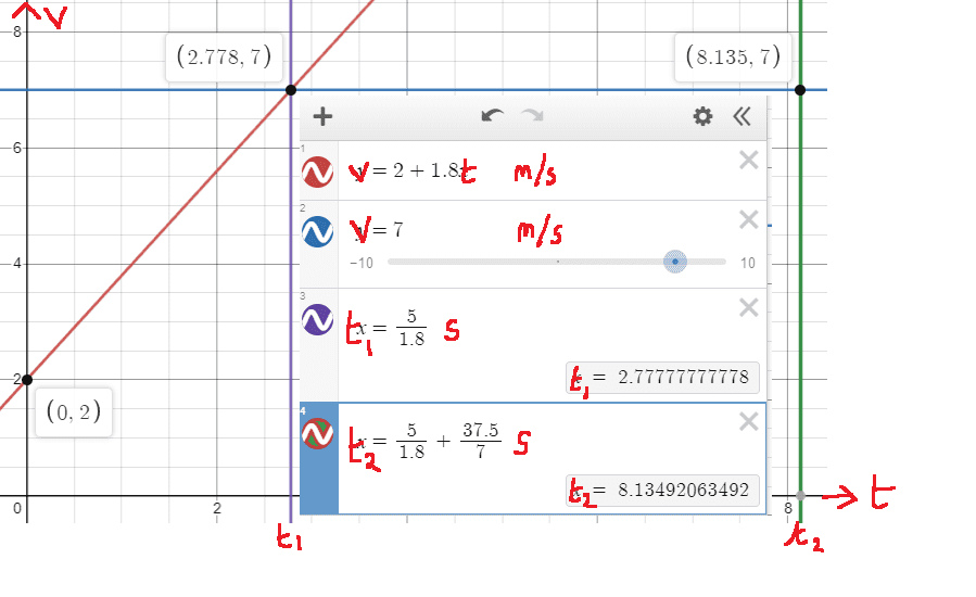

Except, I don't get ##125m## for the second phase. At ##t = 5s## I get: ##x_{car} = 125m## and ##x_{truck} = 127.5m##. The car still has a little bit of catching up to do.
Ah, youre right, maybe I'm trying to rush the answer and make silly mistakes like that on the way, t = 5.35s seems to be pretty close, i tried it by trial and error. 5.35s and 133.75m
Trial and error is okay, but you still need to find the right answer. It's better to use the equation now that you understand what's going on.
What equation should i use if i don't use the trial and error, isn't the equation you gave Xcar = Xtruck basically using trial and error?
  • #31
No, because you have:
The position of the car is: $$x_{car} = 0 + v_{car}t = (25m/s)t$$ and the position of the truck $$x_{truck} = 37.5m + v_{truck}t = 37.5m + (18m/s) t$$ where ##t## is the time from the end of the car's acceleration phase.
The equation you need to solve is $$x_{car} = x_{truck}$$
And, that's not a hard equation! You need to solve for ##t##, of course.

$$x_{car} = (25m/s)t$$ $$x_{truck} = 37.5m + (18m/s) t$$ $$x_{car} = x_{truck}$$
You can use the third equation to collapse the first two into a single equation involving neither xcar nor xtruck. Can you see how to do that?
This leaves you with an equation in which the only unknown is t.
If you gather all the terms involving t onto one side of the equation and all the terms not involving t onto the other side you can find the value of t.
Likes Lnewqban
  • #35
haruspex said:
This is standard algebraic manipulation.
Look at @PeroK's equations:
Sorry for taking so long to answer, i understand now, (25m/s)t=37.5m+(18m/s)t -> 25t-18t=37.5m -> 7t=37.5m -> 5.36. Thank you @PeroK and @haruspex for bearing with me, i do appreciate it :)
