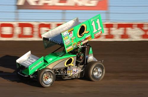

First, Mark, what you are describing is a wing, not a spoiler.
Second, yes, a vertical wing can be be used to generate force in the direction of the turn and either lessen the force needing to be generated by the tires for the same cornering speed or to increase the overall cornering speed (usually the reason for using them!). Winged dirt Sprint cars have very large side panels that do exactly that, although the panels are just flat and not wing shaped. Because of the large slip angles that these cars use while cornering on dirt, the side panels have a significant angle of attack and generate enough force to justify using them.
Third, having the force from the wing acting above the roll centre of the vehicle will counteract the vehicle's typical roll reaction to the forces generated by the tires while cornering. Again, dirt Sprint cars with large side panels on their wings benefit from this, reducing the amount of roll that the car experiences while cornering. This allows the use of softer springs and anti-roll bars which generally allows the tires to work better.
This is an all sweeping answer that is is only valid in certain situations.
You mention sprint cars, they run on ovals and are only required to turn one way.
The ovals are generally banked.
They are running at a fair bit of speed.
And an angled wing would increase force per slip angle for a given load, which can't really be described at reducing the load on the tyres.
http://www.world-sprintcar-guide.com/sprint-car-wings.html
It'll certainly cancel the tendency to roll, but certainly won't stop load transfer.
So if he takes this knowledge from 140mph sprint cars that only turn left, and sticks a fin on the top of his Lacetti (or other reasonably priced car) and and sets off into the wild blue yonder. Whats going to happen?

In theory your wing would help the car by adding aerodynamic side force to that being generated by the tires, and yes the car would still turn but the handling would be slightly different. So you are a little bit right but not for the reason that you're thinking of.
The Sprint cars obviously benefit from them but are a special case as Chris mentioned. The reason I mentioned the dirt cars is that they typically corner with quite a bit of slip angle on the dirt, which would give the side panels (or vertical wing) a reasonable angle of attack. If the wing was neutral to the car (i.e., aligned fore and aft), the wing would generate side force when cornering in either direction. On pavement, the slip angles are much less and the car would likely not benefit much unless the wing could move like a rudder (not legal in any racing classes I know of).
In practice, a road car would be much better off using a horizontal wing or a spoiler to increase downforce on the tires to increase traction.

DaveC426913 said:
I think it will render the vehicle uncontrollable.
How would it do that?
  • #34
Powerful transverse forces on the vehicle right in the middle of a turn?
  • #35
I'm not sure how you're visualizing this, but I can tell you that powerful transverse forces are always acting on the car during cornering, ones that are not always balanced or predictable, and the driver is expected to compensate accordingly.
I'm not seeing a situation that renders the vehicle uncontrollable, so if you have one in mind I'd be interested in reading about it.
