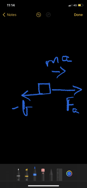

Ok!
I suppose the square object in the FBD is the tyre. What agent external to it exerts force ##F_a##? In post #3 you correctly answered @haruspex's query that, if the contact were frictionless, the tyre would not accelerate. Well then, when the friction disappears, this ##F_a## must also disappear. How can that happen if the external agent exerts it away from the contact point?

Your free-body diagram is not yet correct. First, what kind of friction do you think is happening? Static or kinetic? Then, think about how the action of the motor ends up making the car accelerate. If you have a little wheel try and turn it against some surface with friction and feel what the wheel wants to do.
kuruman said:
suppose the square object in the FBD is the tyre. What agent external to it exerts force Fa?
Why have we started talking about tyres. In previous questions we talked about whole bodies as one. So why have we now started talking about their parts?
of course kinetic.
That was rigid bodies. A car going along a road cannot be treated as a rigid body since the wheels rotate.
Edit: checking back I see that the issue here is that kuruman misinterpreted the FBD. Likely the square object was intended to represent the car as a whole, not just a tyre.

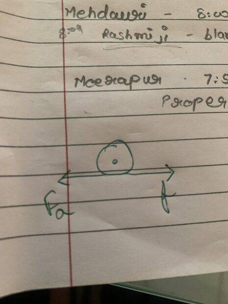

Seems right! My question is :
1. First of all this is not the question of car but of tyre, more accurately.
2.Net force is zero on tyre. ##F_a=f_s##. But the car /tyre is accelerating which defies Newton’s second law!
You have not defined ##F_a##, but used it as though it is the net horizontal force on the car, including the wheels.
If the wheels have mass m each and the car has mass M, ##f_s=(M+4m)a##. The action/reaction between each wheel and thar car is ##(M/4)a##, and the net force on the wheel is ##ma##.

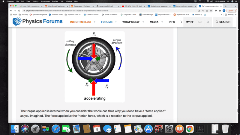

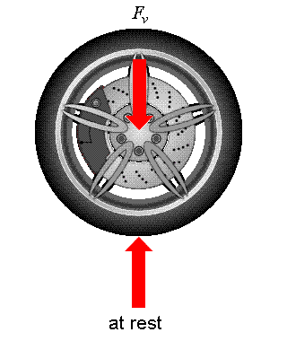

You have to do the free body diagram for the wheel alone. You will have a torque applied (coming from the motor) and a reaction from the friction force. This should clarify what the direction of the friction force is.
Here's what it should look like (including the concept of rolling resistance, in green):
The torque applied is internal when you consider the whole car, thus why you don't have a "force applied" as you imagined. The force applied is the friction force, which is a reaction to the torque applied.
Likes sysprog and kuruman

Doc Al said:
There is no additional "applied force" (Fa) that I can see.
Why? What about the torque delivered by engine to the wheels?
  • #31
As others have pointed out, treat the car (including its tires and all other parts) as a single object. Treating the tires as separate objects only creates more work with no advantage.

bob012345 said:
Yes but even this is leaving out the force between the body of the car and the wheel which I am in favor of
No, it doesn't, it is applied at the axle on the shown figure. That is the applied force to the body that the OP is looking for; assuming the wheel mass is included with the body of the car for simplification.
bob012345 said:
but we should not say this is the diagram of the wheel alone but that it represents the whole car in this problem.
No, there is no torque applied to consider when analyzing the whole car.
The wheel torque explains why the friction force seems to be "backward" compared to a sliding block. This is what the OP doesn't seem to understand. The wheel mechanism reverses the friction force direction, thus propelling the car instead of braking it.
Likes sysprog
  • #40
bob012345 said:
The torque turns the wheel but because of the static friction between the wheel and the road, the wheel pushes on the road and the road pushes back on the wheel according to Newton's Third Law. The wheel then transmits that force to the rest of the car and the whole car accelerates together.
Edited:
Ok! I got it now! So as I was thinking ##F_a(applied force by the wheel)=f_s##.static friction. Both ##F_a## and ##f_s## are necessary for acceleration of the car. Without ##F_a## there is no ##f_s## and without ##f_s## car would not accelerate.
So, $$f_s=ma$$
M is mass of car body and m is mass of tyre.
And the rest is same in #post15.
Newtons laws hold true!
Thanks everyone!

  • #48
jack action said:
No, it doesn't, it is applied at the axle on the shown figure. That is the applied force to the body that the OP is looking for; assuming the wheel mass is included with the body of the car for simplification.No, there is no torque applied to consider when analyzing the whole car.
Frankly, I'm a bit confused looking at this free-body diagram. Is it for just the wheel or the whole car? It seems it would be hard to understand in either case since all the forces apparently cancel out even though it assumes the case of acceleration.
  • #49
This diagram is confusing me too since friction>force applied by the wheel.
  • #50
Ignore the green friction. That is something called rolling friction which is a different kind of resistance to rolling motion and is not considered in your problem. The only friction you need for this problem is static friction, what they gave you, because the wheel is not slipping with respect to the ground. The wheel applies a force to the ground and the ground applies a force to the wheel. The wheel accelerates forward and the ground (road) accelerates backward (again Newton's Third Law) but at such an imperceptibly small rate as to be considered zero.
Also note, you were not given the mass of the wheels, just the car as a whole. That is a big clue you don't need to treat this as a complicated problem with multiple parts. Just one car as a whole of total mass ##m##.
