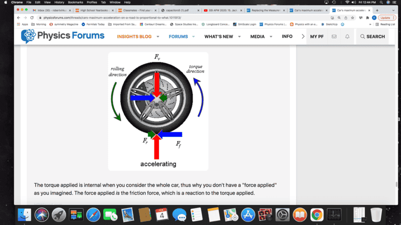

bob012345 said:
Ignore the green friction. That is something called rolling friction which is a different kind of resistance to rolling motion and is not considered in your problem. The only friction you need for this problem is static friction, what they gave you, because the wheel is not slipping with respect to the ground. The wheel applies a force to the ground and the ground applies a force to the wheel. The wheel accelerates forward and the ground (road) accelerates backward (again Newton's Third Law) but at such an imperceptibly small rate as to be considered zero.
I may have missed something before but I am again asking if it’s static friction between the road and tyre how is the tyre/car accelerating?
  • #52

Looking at the following figure:
  • Ignore the green arrows;
  • The wheel torque ##T_a## is shown in blue (torque direction). That is the applied torque coming from the motor;
  • The reaction force to this torque is the Friction force ##F_f##. It is pushing the wheel forward;
  • The blue force at the axle (center of the wheel) is equal and opposite to the friction force ##F_f##. The distance between the two blue forces (wheel radius ##r##) times the force's magnitude represents a couple that opposes the wheel torque;
  • ##F_f = \frac{T_a}{r}##. The maximum possible value is equal to the static friction force;
  • If you would do the free body diagram for the car's body, that axle force would show as equal and opposite, thus pushing the car's body forward - so with the same direction as ##F_f##.
The lesson in that is that the direction of the torque dictates the direction of the friction force at the tire contact patch and that friction force is the "force applied" that you talk about and pushes the entire car, coming directly from the torque applied at the wheel.

Is the blue force at the axle on the wheel or not?
  • #67
Yes. It is the force at the axle bearing.

Then how can the wheel accelerate if the two blue forces are equal and opposite and both act on the wheel?

Because the car's body is not fixed and the wheel will accelerate with it.

My point is that if you draw a free-body diagram of the wheel alone, which is perfectly valid, it better have a net force on it if it is undergoing acceleration. You cannot say the net force on the wheel is zero but the car carries it along with it. Every part of the car has a net force on it if it accelerates with the car. Even the driver.

The point of the drawing was just to show how the direction of the friction force can be in the same direction as the body's motion with the introduction of a wheel.

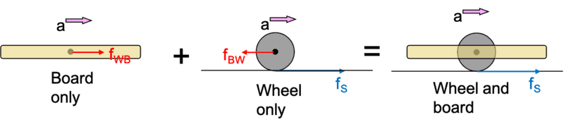

If the OP's question would be exactly the same, except for the car that started at an initial velocity until it stops (thus braking), the answer would be exactly the same.
But the free body diagram - representing the car as a block - would show the friction force in the other direction, i.e opposite of motion, i.e. the "expected way" of a block sliding on the ground (even though there is no sliding involved).
How can you explain the change of friction force direction without explaining how a wheel works and how the direction of the applied torque at the wheel plays a major role in this?

Good point. Frankly, I've entered a bit of a brain fog regarding the free-body diagrams that I have to work out on this problem beyond the basic idea of the static friction being the driving force. :biggrin:

Ok, I resolved my brain fog issue over the free body diagram of the wheel alone. What bugged me in the diagram is that it looked like the blue Axle force to the right was exactly equal to the static friction force to the left which could not be true under acceleration. The total forces left and right are slightly different and total to a net force of the exact amount necessary to accelerate the wheel of mass ##m## by acceleration ##a##. Likewise the driving torque at the axle is greater than the counter torque due to all other torques by exactly the amount consistent with an angular acceleration ##\alpha= \large \frac{a}{R}##.

The diagram I showed assumes the wheel is slowing down. I think the diagram is again wrong like the other one. There appears to be a lot of incorrect free-body diagrams available.
Wheels rolling at some starting speed will slow down due to rolling friction. That much is certain.
jbriggs444 said:
If the wheel is rolling at speed then there is a forward torque from the axle and a rearward torque from rolling resistance. Rolling resistance is a torque, not a force.
It must be both if the wheel is not slipping. What I think resolves this is that the rolling resistance is a distributed force acting over a region of contact (a patch) in such a way that it opposes the forward motion and create a torque which slows the wheel.

bob012345 said:
I did not make that diagram nor originally post it but I reposted it to argue I thought it was wrong. Here is another free-body diagram I found of a wheel slowing down by rolling resistance. It looks like it would have a torque that would speed the wheel up but we know it does not so there is something about the way friction works at the point of contact that I'm just not getting. It is easy to see how ##F_{rr}## will act to slow down the wheel but I don't see how the torque ##RF_{rr}## acts in the correct direction. I wonder if it has something to do with the point of contact actually being the center of rotation? And where is the static friction in this diagram? The brain fog continues...
https://www.physicsforums.com/attachments/296631
https://archive.thepocketlab.com/educators/lesson/rolling-resistance-physics-lab
The Post #85 diagram shows rolling resistance as a simple horizontal force acting at the base of the wheel, vertically below the wheel's centre. This is an inaccurate simplfication and (as has already been noted) gives a torque which would tend to accelerate the wheel!
A better representation is this: https://www.lockhaven.edu/~dsimanek/scenario/rollres3.gif
For this diagram and accompanying explanation, see the section entitled “Rolling Resistance” about halfway down this link: https://www.lockhaven.edu/~dsimanek/scenario/rolling.htm

bob012345 said:
Ok, I resolved my brain fog issue over the free body diagram of the wheel alone. What bugged me in the diagram is that it looked like the blue Axle force to the right was exactly equal to the static friction force to the left which could not be true under acceleration. The total forces left and right are slightly different and total to a net force of the exact amount necessary to accelerate the wheel of mass ##m## by acceleration ##a##. Likewise the driving torque at the axle is greater than the counter torque due to all other torques by exactly the amount consistent with an angular acceleration ##\alpha= \large \frac{a}{R}##.View attachment 296601
The diagram is not a true free body diagram (FBD).
It's a simplified schematic version to explain the relationship between force and torque directions.
What is important to understand is that a rolling wheel can reverse the friction force direction by reversing the wheel torque, even if the rolling direction stays the same.
In an accurate FBD, yes, there would be wheel accelerations to consider (both linear and angular). BUT THIS IS IRRELEVANT TO THE PROBLEM AT HAND. It would only confuse the OP to make an FBD for each wheel and the car's body. Just imagine the wheel is massless and the car's body is heavier by the equivalent of the wheels' masses.
Rolling resistance should also be ignored for this discussion. IT IS IRRELEVANT TO THE PROBLEM AT HAND and can only confuse the OP.

Here are 3 FBDs related to the one-wheel skateboard mentioned in post #21. To make things simple, only horizontal forces are shown.
##f_{\text{S}} = ~## force of static friction exerted by the road on the wheel.
##f_{\text{WB}}=~## contact force exerted by the wheel on the board at the axle.
##f_{\text{BW}}=~## contact force exerted by the board on the wheel at the axle.
To @rudransh verma:
The sum of the board and wheel FBDs is the FBD of the one-wheel skateboard. The board, the wheel and the combined board + wheel have a common acceleration ##a##. What is the net force in each case that provides this acceleration?
A picture is worth 103 words.
All preamble aside, what if one wishes to use the term "rolling friction"? Personally I would be inclined not to use it ever. Is there a reason to put it in the elementary curriculum (as yet another frictional force??) Just askin'
