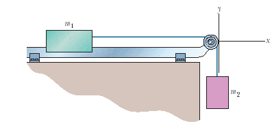

The figure shows an arrangement with an air track, in which a cart is connected by a cord to a hanging block. The cart has mass m1 = 0.670 kg, and its center is initially at xy coordinates (–0.550 m, 0 m); the block has mass m2 = 0.290 kg, and its center is initially at xy coordinates (0, –0.280 m). The mass of the cord and pulley are negligible. The cart is released from rest, and both cart and block move until the cart hits the pulley. The friction between the cart and the air track and between the pulley and its axle is negligible. (a) In unit-vector notation, what is the acceleration of the center of mass of the cart–block system? (b) What is the velocity of the com as a function of time t, in unit-vector notation?

I don't understand what I am supposed to do. I know how to find the acceleration of the system, but I am not sure how to find the com acceleration. My guess would be something along the lines of xcom = (m1a1*x + m2a2*x)/(m1a1 +m2a2). Then do the same for the y axis. Then to find the velocity all I would have to do would be to find the Integral of com of Acceleration? I am stuck.
Somewhat like that, yes.
But you want an answer which is an acceleration vector, so you don't want to be dividing by accelerations.
Try considering one coordinate at a time.

Well I know in either direction, one of the forces will be canceled out because the each mass as a zero in their coordinates. Would I want instead xcom = (m1a1*x)/(m1+m2)?
You are not stuck. The real formula for the acceleration of the center of mass is much simpler and involves only m1, m2 and a1 and a2. Integrating that will be much simpler.
To compute the postition, the speed or the accelaration of the center mass you use the same formula each time, based on calculating a weighted average.

So are the x and y coordinates useless then in this equation? They are throwing me off.
Look at your lecture notes or books. How is the position of the center of mass defined?
Velocity is the time derivative of position; acceleration is time derivative of the velocity.
So what are the components of the acceleration vector of a two-body system in terms of the individual accelerations?
It is weighted average of mass and position. I just don't know how to apply it to this problem. The individual accelerations of this equation are 2.96 and -2.96. I just do not know how to convert this to a center of mass equation.
Write the coordinates of each mass in the (x,y) form and take the weighted average to find the coordinates of the mass centre. Then differentiate as necessary.

I'm still confused. Differentiate how? I found the center of mass but how do I differentiate it to give me velocity and acceleration?
So I found the correct answer to the acceleration problem. How do I integrate the vector notation of the acceleration to give me the velocity?
Never mind. I figured it out. I'm stupid.
