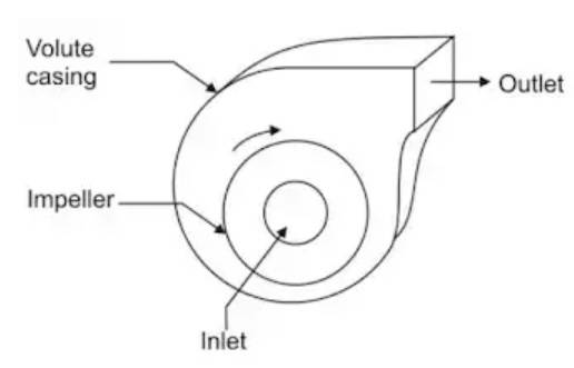

Assuming that your term "centrifugal compressor" refers to a high speed blower as in the simplified diagram below:
The velocity of the air at the outlet is a function of flow rate and outlet flow area. The flow rate is a function of the back pressure, where the function is shown by the fan curve. Search that term, the Aerovent link is a particularly good introduction: https://www.aerovent.com/wp-content/uploads/2018/12/Understanding-Fan-Curves-FE-2000.pdf.
What is the "slip factor"? Air flow around impeller vanes is analyzed using velocity triangles, such as are found using search terms blower velocity triangle. The book Centrifugal and Axial Flow Pumps, 2nd Edition, by A. J. Stepanoff has an entire chapter on the subject. It is a good resource if you want to get deeper into the subject than a simple internet search. The analysis of a blower is identical to the analysis of a pump until you get into compressible flow. Air, or any gas, is merely a low density fluid.

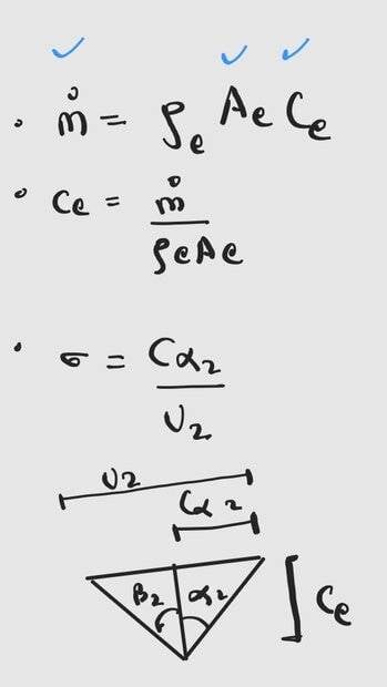

Turbomachinery design involves lots of initial assumption, iteration and then validation.
Assuming you have you mass flow rate and inlet and outlet condition from your thermodynamic anaysis. Then you can evaulate the axial exit velocity from continuity equation. From slip factor you can evaluate your velocity triangle because you have the blade speed at the exit.
Assuming you have you mass flow rate and inlet and outlet condition from your thermodynamic anaysis. Then you can evaulate the axial exit velocity from continuity equation. From slip factor you can evaluate your velocity triangle because you have the blade speed at the exit.View attachment 344830
I don't have my mass flow rate. That is the problem. I need to know the radial component of the velocity through the impeller to calculate the mass flow rate from the density, velocity, and cross sectional area. All I have is my impeller geometry and the RPM. I would imagine the radial component of the velocity could be approximated by an equation using centrifugal force but I haven't seen any information about it.
