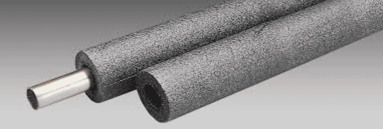

Insulation only prevents heat from transferring from hot to cold so quickly.
Insulation between the pipes and floors above will reduce the amount of heat the pipes will get from the house.
I have pipe insulation on hot water pipes to prevent heat losses from the hot water heater to the point of use.
It won't heat the pipes, just retain more heat that is already in there.

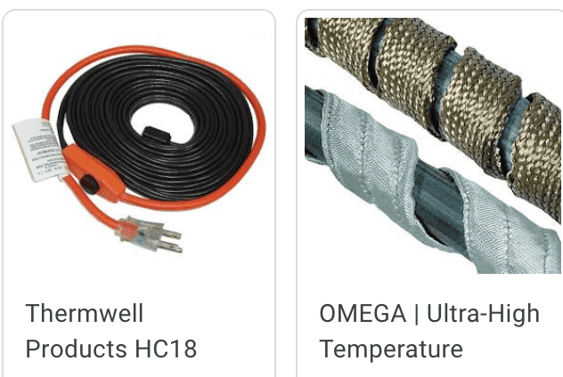

in a couple of places, I have some plug in heater tapes wrapped around exposed pipes with a thermostatic control that only turns on near freezing (its a product in hardware stores). This is like an electric blanket.

Alternatively temperature monitoring and a heat source can keep things from freezing. The pipe insulation suggested above in my experience without a heat source such as heat tape is only for the higher end of the freezing temp range.
